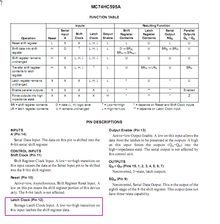

Quick question on this chip.
If I tie the latch enable pin permanently high, will the data being shifted into the serial register appear immediately on the outputs, ie does the latch go transparent.
Flicking through the datsheet it says that if you connect the serial register and the latch register clock inputs togther the o/p will allways be 1 clock pulse behind, making me think theres some weird syncro stuff going on.
I'd like to use one of these instead of a 74hc164 as I have a drawer full.

This is a clip from the d/sheet, its a Low to High transition of the Latch Clock.
Is this the pin you are querying.?
I don't see a Latch enable, only an output enable.

There are diffrent legends for the same pins on various sheets!
In essence what I'm saying is that if I tie the latch enable/latch clock/data transfer or whatever its called to active (high) would the latch become transparent, meaning would the o/p from the latch match the i/p, in other words the 'hc595 would behave like a 'hc164.
The datasheet eric just posted shows latch clock edges further making m think its not going to work.
I would suggest a quick hardware test with an actual HC595, a bread board circuit should show how the pin works.
Let us know what you find.

I don't think it's "weird syncro stuff", it's just the way a clocked latch works.
It's similar to having two flip-flops in series with a common clock.
The second FF's output will always be one clock delay from the first FF's output (like a shift register operates).
So I suspect that's how the 74hc595 output latch operates.
If you want to minimize the delay between the S/R bit change and the latch output, then you can delay the S/R clock to clock the latch after the S/R output settles where the delay is slightly longer than the clock setup time [SRCLR high (inactive) before SRCLK ↑ in the data sheet].
A Schmitt trigger (such as two 74HC14 Schmitt inverters in series), with possibly a small RC delay at its input if needed, can provide this clock delay.

I have 2 lines into the chip, data and clock, data goes to data in on the register, clock goes to the register clock input and then delayed through an r/c into the latch enable input, so the regsister shifts data in, then a few us after the latch is latched, effectively removing the latch section of the chip, its acting like an unlatched shift register, pointless but saves me having to buy parts.

Yes and no, not so much saving a pin, I wanted to use a '595 as an unlatched register.
I succeeded.
