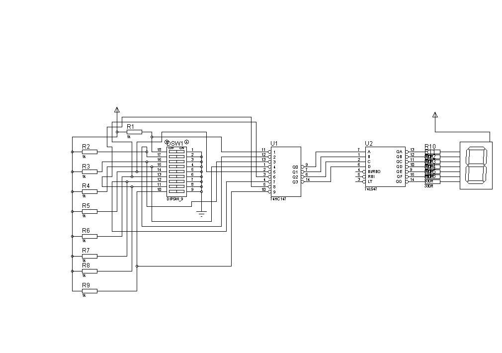

Hi All ,
i have attached the following image for my schematic , but i actually have alittle problem , that some selection when i select produce digits cannot displayed correctly on the 7 segment due to the limitation of the 7 segment from 0 to 9
so i need to add more 7 segment to accept higher number like 14 and 16 .....but i don't know how to wire the new 7 segment could you help me please

For additional digits, simply duplicate what you have for each additional digit. For any simple configuration of a 7447/74LS47, you need not connect anything else on the '47. If you need leading zero blanking, connect the BI/RBO of the more-significant stage to the RBI of the next-least-significant stage. The most significant stage will have the RBI connected to ground (LOW) to start the blanking. If RBI is LOW, then that stage will blank a zero. If a stage blanks a zero, its BI/RBO output will go LOW, signalling to the next least-significant stage that it has blanked and that it can blank if it has a zero. The lest significant stage usually has the RBI connected to +5v (HIGH) so that it never blanks, assuring you that the readout is "live". BI/RBO is an input and an output. If you force BI/RBO LOW, that digit will blank regardless of the ABCD input. This can be handy for flashing a display for a warning, such as an overrange condition. LT is normally connected to a HIGH. Bringing LT LOW forces all segments ON as a "lamp test". I don't like floating inputs. Even though the '47 has pretty reliable output with these control input floating, I still make sure they're HIGH if I need them to remain so by connecting them to +5v. Be aware that any ABCD input that you do not must absolutely MUST be connected to a LOW or your display will not produce the correct readout.

You also have the problem of converting binary to decimal unless you intend to display 4 binary bits as hexadecimal. The short list for binary to BCD conversion is:
  1. Decoding ROM
  2. Decoding PLD or FPGA
  3. Microcontroller
A pair of small microcontrollers would simplify the project. And you could reduce the amount of data lines between them to 1 + GND

Back OT, my favorite decoder/driver is the expensive and difficult-to-find 9368, an all-in-one decoder, driver, current source, hexadecimal displaying cutie that eliminates the seven current-limiting resistors required for the LED segments. There are also a couple of CMOS D/Ds that will display hex. The 7447 will display input above 1001b, but only as cryptic characters that need decoded in their own right and 1111b displays as a blank character (not a blanked display because with a LOW on the RBI and 1111b as the data input, the BI/RBO does not go LOW).
