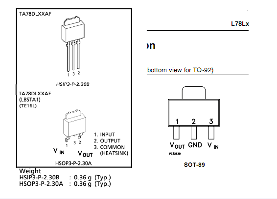

Hi, I found a bunch of 78DL05AP voltage regulators in my junk box. I assume it has the same pinout as LM7805. However. when I applied 9V to it, all I get is 8.9V output. This is the same for all these chips. Can I assume that those chips are faulty? It's hard to believe all of them are faulty!

Don't assume, check the datasheet. I had a quick look at the Toshiba sheet, and it claims the legs are numbered left to right 1,3,2. Which I thought was strange for a start.
Thanks eric, that's the datasheet I am using too. The part suffix is AF but I believe the pin layout should be the same. My 78DL05AP has the same packaging as other 7805s I am using. So I believe mine are faulty. What possibly could have caused all of them (~20) to fail? :(

I dont make the pin out the same.???
Hi, I noticed that too. But I believe it's just the numbering: 1: Input, 2: Output, 3: Common and the order is 1,3,2 so it should not be so strange. I tried various combinations just for the benefits of doubt and could not get the correct output
Hi, I noticed that too. But I believe it's just the numbering: 1: Input, 2: Output, 3: Common and the order is 1,3,2 so it should be the same as a normal 7805.
Try one as per that image I have just posted,, I hope you have not damaged any with a reverse voltage.

I have some of the 78DL05ap's made by toshiba and if you do not put a 100 micro farad cap on the output they will also not give you 5 volts instead they output just about the input voltage, I was told to use low ESR caps not sure if you have to as I have only used the low ESR caps.
Beware - you need input and output decoupling caps close to the pins. I have used the 7805 type regs without decoupling caps and the parts oscillate. Electrolytics should be OK.
