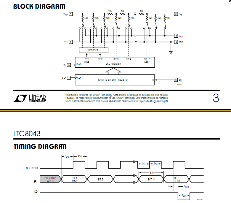

This image clip from the datasheet explains the 3 wire control required.
Using only 8 clocks will only output the 8 MSB's of the 12 bit data value.
Also 8 bits will not 'flush' thru the residual 4 bits from the previous conversion.
Use two 8 bit S/R's, to give12 clock pulses and a 13th /LD pulse.
OK.?

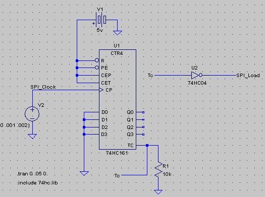

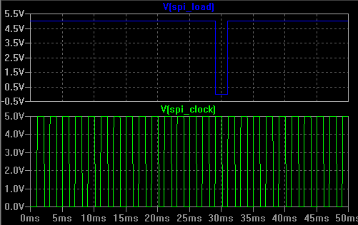

Okay, that clarifies things. Maybe you could simply use a counter like a 74hc161 to generate LD (using invert of counter terminal count) on the 12th clock. For the data line use a switch that is either +5v or 0v in essence you clock all 0's or all 1's. LED will either be on or off. That would give you a general idea of functionality. Actually you don't even need to set the counter for 12 bits, just let it generate Terminal count at 16 clocks. Since data is all 1's or all 0's it is a don't care about the extra clocks. I think that would work.
See attached below.
Oh, and R1 on schematic is not needed.

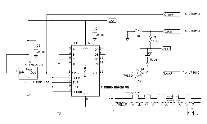

No, you don't need a shift register at all. You simply use the circuit I showed to shift in all 1's or 0's. See attached below. Just hook up as shown in diagram directly to LTC8043 pins. I think I see what Eric is suggesting and using the PC is probably a better way to go so I this is schematic is just for your reference.

Hi Mike,
I was also thinking about a set of 12 pre-set DIP switches for the data lines (set Hi or Low). Is there a way to design this so as to avoid the user toggling the data switch 12 times to get 12 pulses into the DAC ??
Thanks again.
Hi Mike,
Thanks again.
You seem to be missing the scheme. The user would not need to flip the switch 12 times. User either sets switch in 1 position or the other. LED either on or off. Essentially you clock in 12 zero's or 12 ones. No real timing issues to worry about.
I really think Eric's idea of using a PC will be the way to go as it will give you much more flexibility and can be used for large portion of your board test. Of course this may require some software and hardware. Have to wait and see what Eric suggest.
I have to leave in about 30 mns for a 10 hr shift at the hospital so hopefully Eric will chime in for you...
Thanks Mike, I got it now. Was just a little confused. Instead of the CLK oscillator, I am planning on using a 74123 one shot to make a clock. Will that be ok ?
Also, the 74161 count will be changed from 4 to 15. Will that be an issue ?
Everything else will be as shown in your schematic.
Thanks for all your help..
