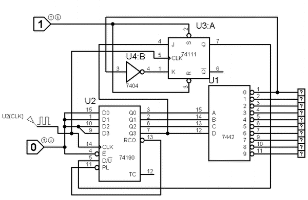

Hello guys, well I have a problem, this circuit:
There are 8 leds, when led 1 is on all others are off, when 2 is on all others are off, etc. It must start in led 1 and end in led 8 and then go back to led 7, 6, 5 etc to led 1 and so on.
(If you have Circuit Maker is the Led.ckt file just bigger -8 Leds-).
I have to do this without the Data Sequencer, just using flip flops, gates, etc.
Thanks in advance for your help. :wink:
You can do this with a simple shift register. Each clock you shift in another '1'. When all the LED's are lit toggle a direction bit in a flipflop that causes '0's to be shifted in from the other side.

Here's my attempt. The resistor/capacitor will set how fast it will go. The 8 wires on the right go to the 8 LEDs. The 2 gates at the top are NOR gates even though they look like NANDs.
Edit made image bigger so numbers can be read.
Hi Pmmie,
Don't use both inputs on the 4093 Schmitt oscillator. Connect one input to its positive supply. You can use the 4093 for the flip-flop too.
If you don't use current-limiting resistors for the LEDs, the LEDs will load-down the output and the flip-flop won't work. Current-limiting resistors woill reduce the brightnes way down, so buffer each output that feeds the flip-flop with a couple of inverters or emitter-follower with current-limiting resistor to drive its LED.
audioguru said:
Hi Pmmie,
Not really. If you use nand gates for the bistable latch then the inputs are active low rather than active high. In other words, the inputs have to be held high and one of them taken low to activate it.

Are most of the LEDs driven directly from the 4028 without current-limiting resistors? Are the LEDs bright enough? What supply voltage?
I doubt CMOS will drive anything direct. If I remember correct, the B series were buffered, which meant they could supply more current - still I doubt it would drive an LED at any reasonable brightness. I assumed this was a logic exercise and therefore we didn't worry about such trivial matters as driving capability. :roll:
Edit, The NAND symbol is what is drawn be Eagle as a NOR. That's what you get for using free software. - Still a very useful program though.
With a 9V battery I directly drive fairly bright LEDs from B-series Cmos all the time. 8 to 10mA isn't bad. Try it. Sometimes I parallel a couple of gates or inverters in the same package for extra brightness.
