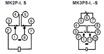

There is also a bit of question as to the MK3P series as MK3P generally indicates a 3 pole relay and it should be a 3 pole double throw relay but those are 11 pin and not 8 pin. The Omron MK2P series are 2 pole double throw and have an 8 pin base.
Here is a link to the MK series. which I hope works.
Attached are images of the MK series MK2 and MK3 pin outs.
Can i possibly convert it into a SPDT ? And how?
Yes, sure you can. Since it is a 3 pole double throw you have 3 sets of poles you can use. You would only use a single set of contacts. You would use one common and the corresponding NO (Normally Open) and NC (Normally Closed) connections.

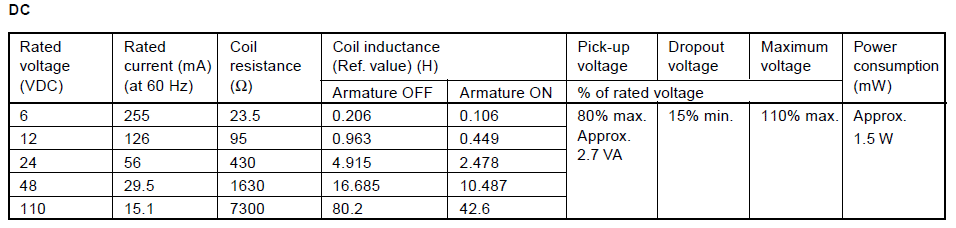

Note the attached from the data sheet.

Did you read the data sheet? The part where it mentions the Pick Up voltage minimum is 80% of the rated coil voltage? That relay will pull in at about 80% of the rated coil voltage. That would be about 19.2 volts. Hell the dropout voltage is 30% min. That relay will not work at 12 VDC with a 24 VDC coil. The best you can hope for is about a pull in at 19.2 volts and that is what the data sheet is telling you. If you wanted or needed a 12 voly coil relay you should have bought a 12 volt version of the relay.
