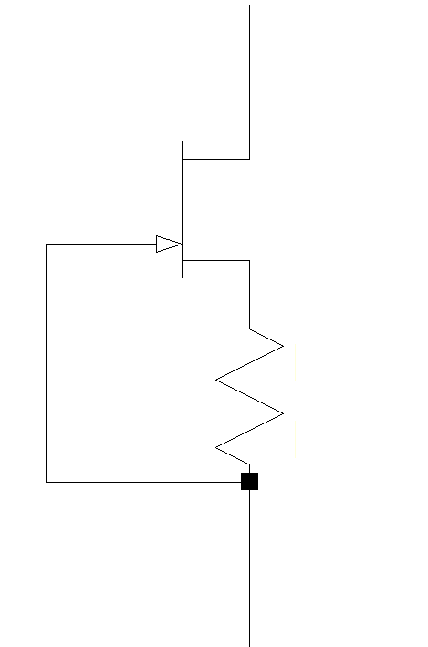

Current Source
When I took electronics in 1970, the instructor showed a "CRD" that regulated the current and could be adjusted and it held a very stable current as voltage varied. I've used them several times, but now I need one that can handle 800 to 1000 ma.
This kind of looks like the current source. Not a lot of head room, but better than the 317.

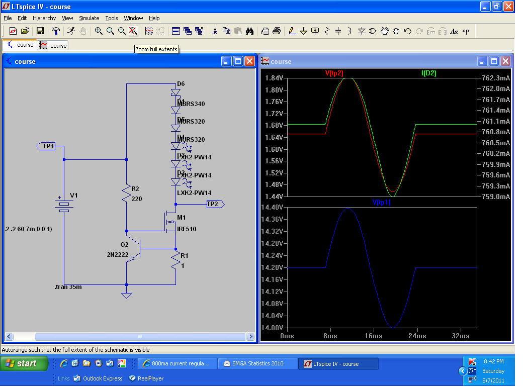

Here is one for 800mA:
That's what I was looking for!

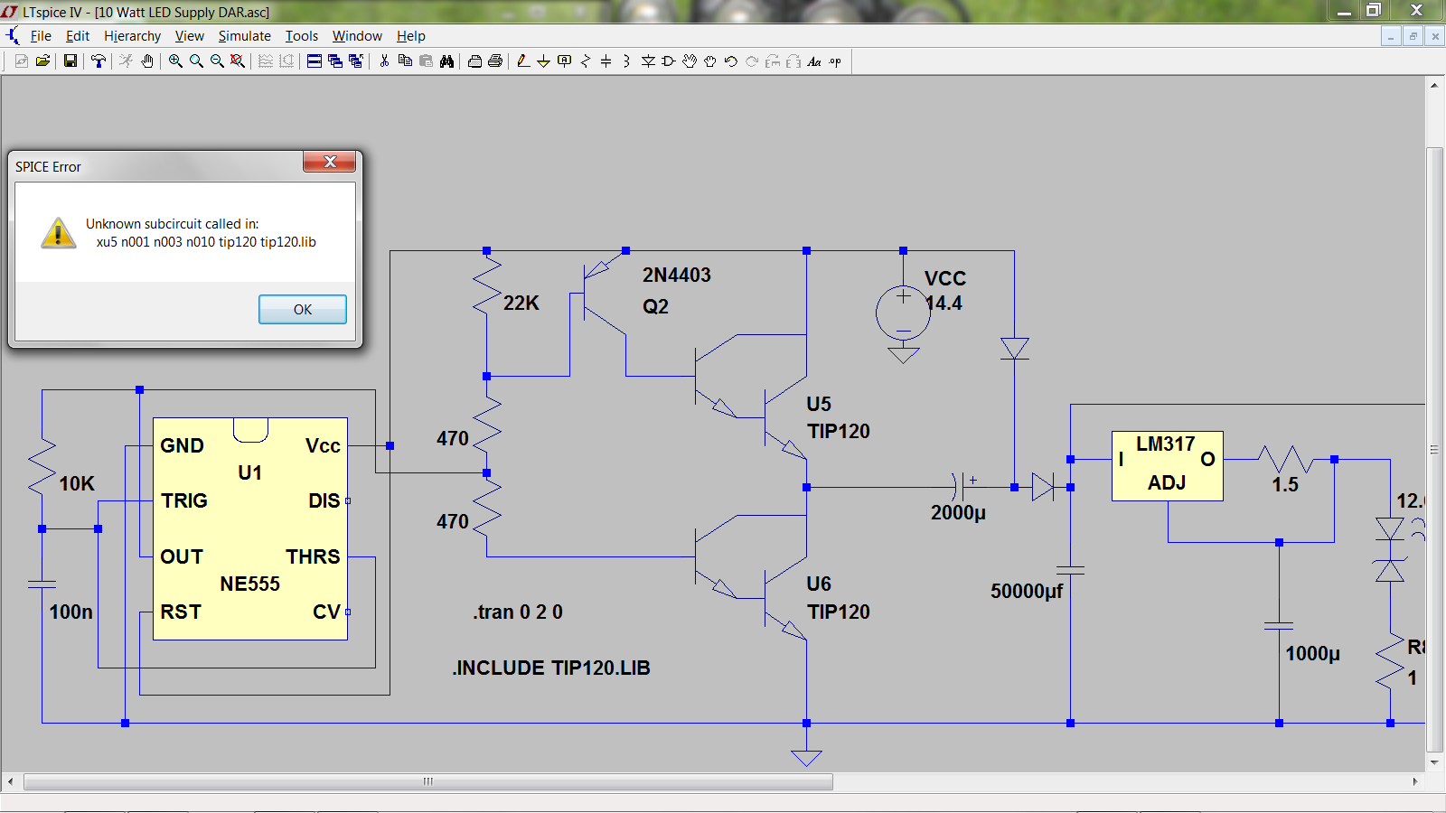

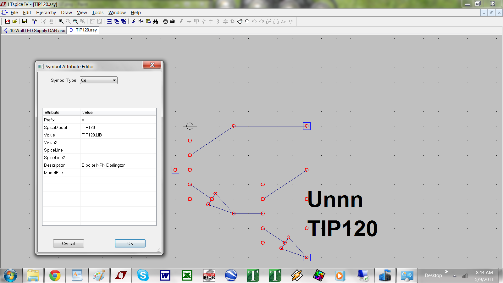

However, my darlingtons don't work on spice.
I prototyped this design using FETs and it worked well, a little heat, but I'm not done yet either, Problem is I'm getting commutation spikes.
Can someone suggest what I'm doing wrong with spice?
Thanks,
Kinarfi

Thanks, I meant to ask about that and why they must be included, and why 2 per leg, the would make about a 3 volt drop.
any idea on what I'm doing wrong with the darlington on spice?
The LEDs are included so there is very little time when both output transistors are turned on.
The waveform has to drop nearly 4v before the top transistor turns on and it has to rise nearly 4.6v before the lower transistor turns on. This give a gap of only 4v and since the waveform is very fast, the transistors do not have much time to start to turn on.
The measured current was much less than 1mA. That's why we can get away with the arrangement.

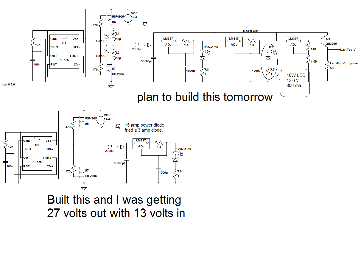

Here's what I have accomplished so far, very pleased.
Kinarfi

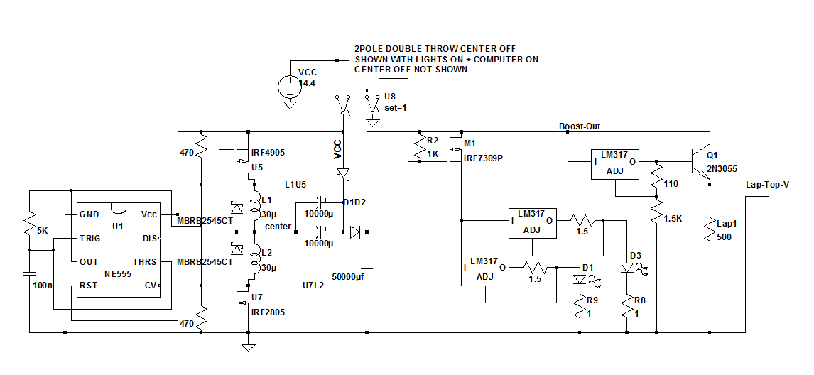

Got my voltage booster working, maybe too good, and I'm not sure why, I added some, inductors/chokes/what ever, to kill the commutation spikes and added Schottky diodes and I'm thinking the inductors are adding extra voltage to the circuit. With 14v in, I'm getting over 40 out. After I moved the 470 ohm resistors so they go source to gate, I quit getting hot FETs, Now I get warm to hot inductors, and my 12.6 10W LEDs run at 823ma beautifully once I pass 10 volts input, I'm pleased!!!!
Can anyone make any suggestions as to why I'm getting so much voltage when not loaded and why the inductors are heating up. Maybe I need to lower the frequency? 175kHz if I remember correctly.
On the schematic, the schottky diodes are STPS3045CT common cathode dual 15 amp diodes with the anodes tied togother. This looks very similar to the chokes I used.
Kinarf

What about putting 2 x 100R inside the 470R's and removing the inductors. Test the circuit for zero current when not loaded. Reduce to 50kHz.
Don't think I can do away with the inductors, with out them, the commutation spikes exceed 200 or 300 amps(according to spice), with them, it's only about 8. I agree that reducing the frequency may be a good idea, I think I'll try for something just over audible, say 25kHz. What is your theory on the 100R s? To delay the turn on time of each FET? I'll save a few screen shot from my scope to post.
Kinarfi
