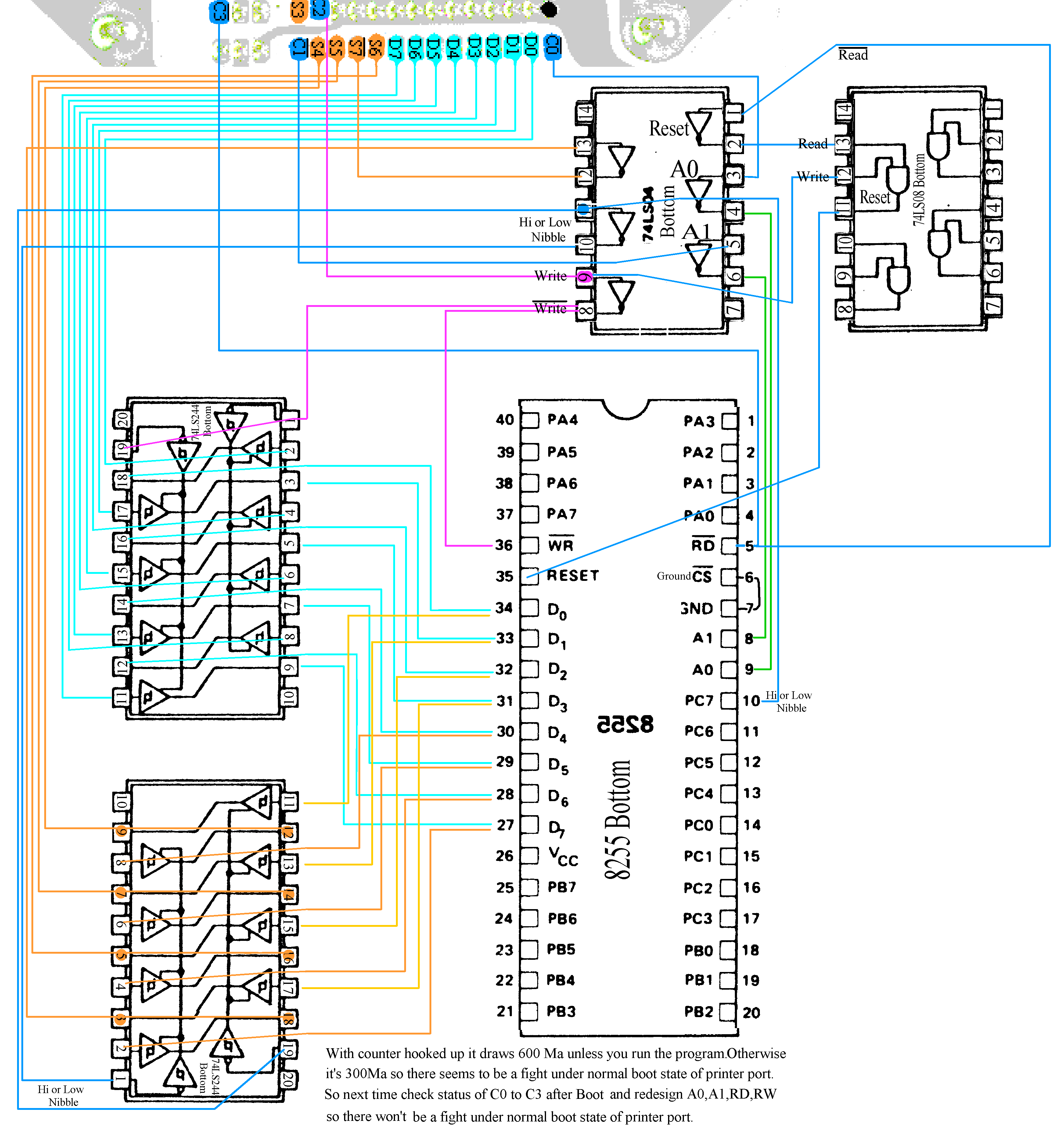

Attached is my 8255 interface circuit and GWBASIC program to “PROGRAM” the 8255 and read 2 bytes from 2 registers, 1 nibble at a time from the LPT1 status byte. After you understand it, you can translate it to C. GWBASIC is free. If you have XP, you will have to run it from an old DOS 5 or 6.2 boot disc.

To start with “yup....8255 is interface I/O IC.....can help me?i really headaching now!!!”, I assume he want to interface to a PC, 80XXX. And “ok......my ADC is for temperature sensor my circuit include 8255+ADC0804+UA741+LM35” he wants to display the temperature on the computer or use it in a program. Before PICs came along, 8255 interface circuit was the best thing that ever happened to electronics hobbyists.
