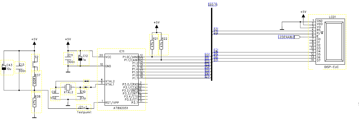

Here's a pretty ungrateful question, which I hope some of you can help me out with:
I have a 89C4051 processor controlling an LCD-display (common HD44780 type) in the 4-bit mode (see attached picture).
Now, things seem to work out fine most of the time, but occasionally, the display is initiated in a bad way, and I get only garbled text on it. If I then hit the reset-button, it usually works fine.
I suspect there may be two sources of faults:
1. The length and type of wiring, which is ribbon cable of around 40-50cm.
or
2. The code, which I wrote my own interpretation of from the guidelines in the HD44780 data sheet.
Here's the code (its a subroutine written in assembler using Keil):

I know this is a rather big question. All comments about the code specifically or just general advice are welcome.
All questions will be answered as best possible.
Oh, I forgot to add, that I left out irrelevant parts of the schematic not to confuse any one. The LCDENABLE pin is tied to P3.3 on the CPU.
As for the board, it has been in use for a long time without the display, and has had no other flaws, so I have reason to believe that all wiring is OK, provided the display itself is wired right.

hi pax,
Are you waiting at least 40mSec after switching ON before you start the LCD init sequence? ..
If the Init seq is at the top/beginning of your program it could be trying to initialise the LCD during this mandatory wait time.
From what you describe, that sometimes the LCD runs OK, others times it comes up garbage,
its an indicator that the LCD is not being correctly initialised.

The problem I experience is that when I start the kit, about half the time, it starts up showing garbage. I then hit the reset tact-switch and then the second init comes out alright and the display works properly for the duration of the session.
As for the complete code, I can paste it into a reply if necessary, but I chose only to show this subroutine at first because it is the only new addition to some software which was written for the board back when it was designed, and the rest of the code doesn't seem to have any problems (of course part of the problem is also that the code isn't optimised, and I don't particularly like the thought of publically flaunting my laziness :p - I'll do it, though, if you think its relevant to solve the problem).
A quick follow-up:
In response to Erics mail, I increased the initial waiting time to 50mS rather than 15mS, and initial tests show that the the error rate has fallen dramatically. The display now only mess things up in 1 of 8 cases, so I think from here on out, its just a matter of tweaking the code.
Thanks for the help.
Hi Pax
Check your code
CALL WAIT_M ;...And then executed.
MOV P1,#110000b ;Port 1 is set up as instructed in data sheet.
CALL LCDTOGGLE_L ;Toggle using lang wait time of apprx. 4mS.
CALL LCDTOGGLE ;Followed by two short toggles of apprx. 100uS.
CALL LCDTOGGLE
MOV P1,#100000b ;P1 is set up to instruct lcd to go in 4-bit mode.
CALL LCDTOGGLE ;lcd toggled to write instruction to lcd.
;Function set - 4-bit, 2-line, 5x8-font below:
MOV P1,#100000b ;Toggle of HI and LO nibble...
CALL LCDTOGGLE
MOV P1,#10000000b
CALL LCDTOGGLE
The first three mov P1,# has olny six bits !!!
What state (0 or 1) will your assemble assign to the two lowest bits?
I wait 250ms before sending anything to an LCD after power up and use 100ms delay between all initialize routines (FunctionSet, EntryMode). After that I use the busy flag to check the state of the LCD.
This is part of the main routine to initialize an LCD. I skipped declarations and subroutines :) If you're interested, let me know.
