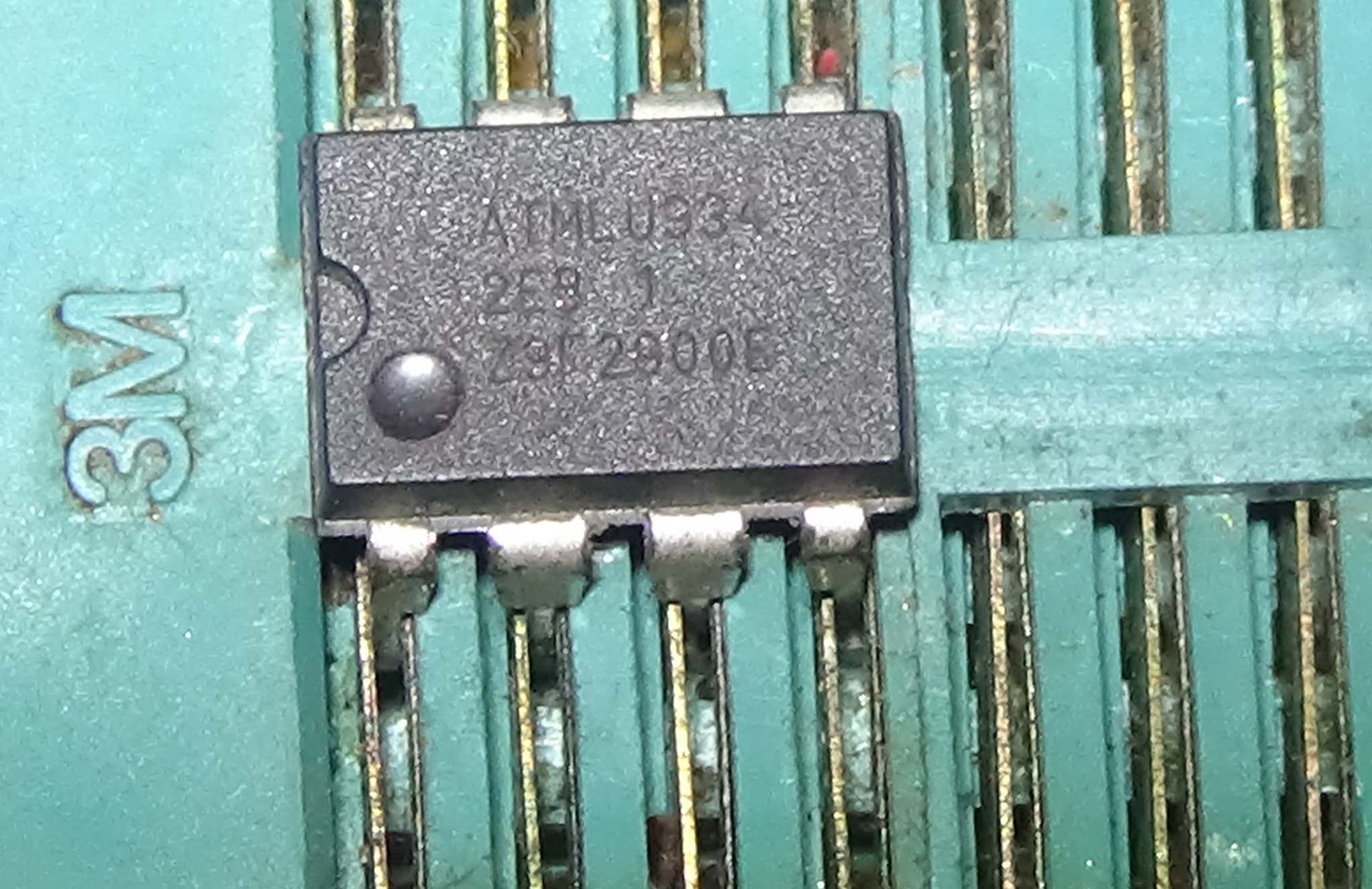

Hello All....
This is the Photo of the Chip "ATMLU 9342EB"....
Any Idea or datasheet for this component?

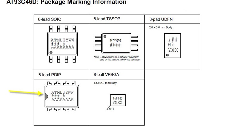

Renewing an old thread here;
Spec already posted a link above which is what you have.
Actual package marking can be confusing; Look at page 14 of the datasheet for the 8-lead PDIP package;
I am using MiniPro Programmer. Its not read the chip o the programmer, But its working in the hardware.
When the time of programing, its shows an error.
I dont understand "ATMLU934 2EB" so, what is the actual number of the Chip. I dont recoganise the chip number with the help of the datasheet. :(
What I do?

OK, One more time;
Instead of attempting to explain the ATMEL's convoluted datasheet, the following is what you have;
Based on your posted picture, provided it is NOT a copycat, the main significant number here is the second row; 2 F B 1
It denotes an obsolete ATMEL two-wire, serial 512K EEprom. Part number AT24C512B.
It was originally designed to ONLY operate between 1.8~3.6V Vcc !
However, date code of (814) week 14/2008 or later added support for 5V operation.-- You have a 934 code which is fine with 5V. ...whew
I am not familiar with your programmer but AT24C512B algorithm must be supported for programming.
waw............Its working. Its a AT24C512B.
This help is most valuable for me, This is really amazing. Thank you vtech.
Thank you so much.
