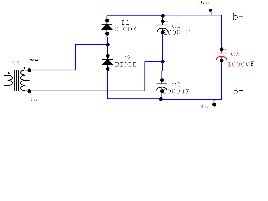

I don't think I could really deal with the ripple... If I had a 5V and a 7V regualted output and I linked them, I would get 12Vs, right? Can someone advise me on this...
A 9VAC transformer gives 9VAC only at its rated output current. It could be 15VAC at a lower current.
If it is actually 9VAC then its peak voltage is 12.7V and its recified and filtered voltage is 11.2VDC. The size of the filter capacitor and whether it has a regulator determines its amount of ripple. The rectified and filtered voltage must be at least 15VDC for an ordinary 12V voltage regulator IC.
Sounds viable, but I've heard sending 5 or 7V back through the 7 or 5V line could break the regulator?
this might help you.

You can use 5 V and 7 V regulator to get 12 V, provided that the voltage supplied is around 15 V (with the consideration of the dropout voltage required by the voltage regulator).
