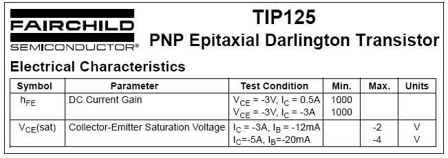

You looked at current gain, when the transistor is linear with 3V between its collector and its emitter.
Instead, look at its base current when it is saturated, it has much higher base current.
ok, then i'll have to raise the base voltage with 10 or 20 more milli amps...
