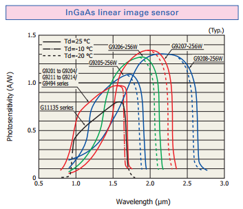

I found this Hamamatsu link that shows the spectral sensitivity for several InGaAs chip designs. Here are the choices for the near infrared:
Source: https://www.hamamatsu.com/resources/pdf/ssd/image_sensor_kmpd0002e.pdf
Note, they do not reach 400 nm. That page also has the typical response for common CCD's for the visible. What do you need sensitivity in the 1.2 to 2.2 µ region for?

I suppose the Hamamatsu does have quite a range, but the area sensors cover only up to 1.2u. The linear is a lot better, but I would really like an area (or a few as you suggested. :)) type which covers up to those ranges.
On the other hand, as highlighted here: https://biomedicaloptics.spiedigitallibrary.org/article.aspx?articleid=1101235 the optical properties does go only up to 1.2u anyway, so probably it's for the better?
