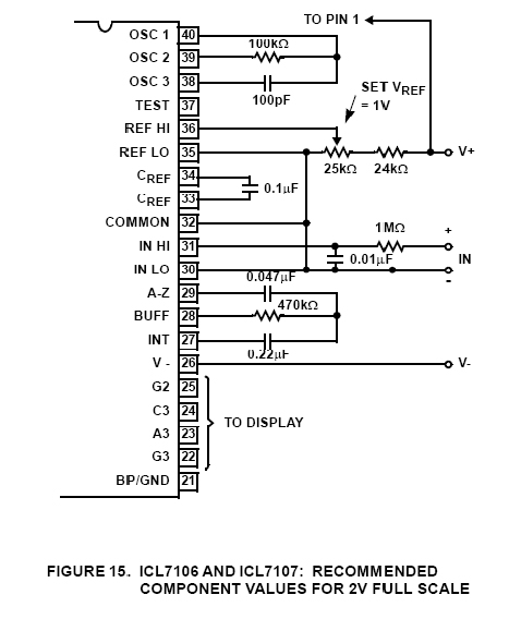

Ivefound a chip that will practically do it all! Its outputs are BCD and needs no control lines or clock :D! All the chip needs is a couple caps and some resistors, along with the decoder chip for the 7segment.
I have another question, reguarding the LM35. I am trying to figure out what the voltage will be at a certain temperature. The data sheet says 10mV/C. Is this 10mV Per C or is it 10mV Divided by C to get V out? The A/D has a 200mV and 20V Capablity.
The A/D Converter is CA3162.

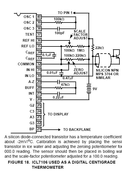

Ive figured out how to calibrate it already, since it wll be reading in C, all I have to do is get a certain voltage (say .5V for 50C) and adjust the display so it will display 50. Of course I might leave the decimal out, but I'll leave the negative sign in.
Should I use the regular circuit or the circuit for temperature sensing? The circuit for temp sensing uses a transistor. It looks like the temp sensing circuit also gives me control over Zero adjust, the other pot is for scale (instead of just 2V, or 200mV It can be changed)
