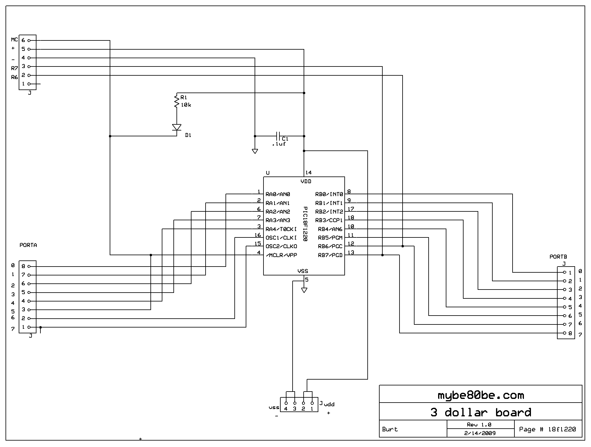

Here how I made it though it would be good to share it with nub's like my self. Here a fast how you do it.
A cheap 3 dollar board for the 18f1220 And a pickit2
Get you a grid style pc board radio shack 276-150 will do 25 pin header strip 1 10kohm resistor
1 1N4148 diode and about 1foot 4 wire phone solid copper. 1 18 pin pdip socket.
Cut you two 8 pin headers one 5 pin header and 1 four pin header and place on board like in my drawing when you get done you will be able to use all the ports to play with have fun
Here the circuit

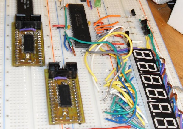

I made the first 1 for a 16f84a then I ran in Nigels web page. I said that so cool all his boards would work with what I made all I needed was more power pins. So made all of his boards. The round board has the set up like a pickit1 you get 6 led from 3 pins

I made similar boards for my students. They use a 18F2585 SOIC and a 2x5 ICSP connector. I reordered the pins so I can plug a LCD display into the BB next to the module on either side without any wiring (8 bit data).
I did not provide a crystal because the uC can do 32Mhz without one.
The board is just wide enough so you either have is span 2 BB's with a pwr BB strip between, or work on a single BB with one row of pins exposed on each side of the module.
In the most current layout there are no jumpers or vias. All the top to bottom routing is done by soldering the header pins on both sides.
I will post Eagle files to rocklore.com if anyone is interested.

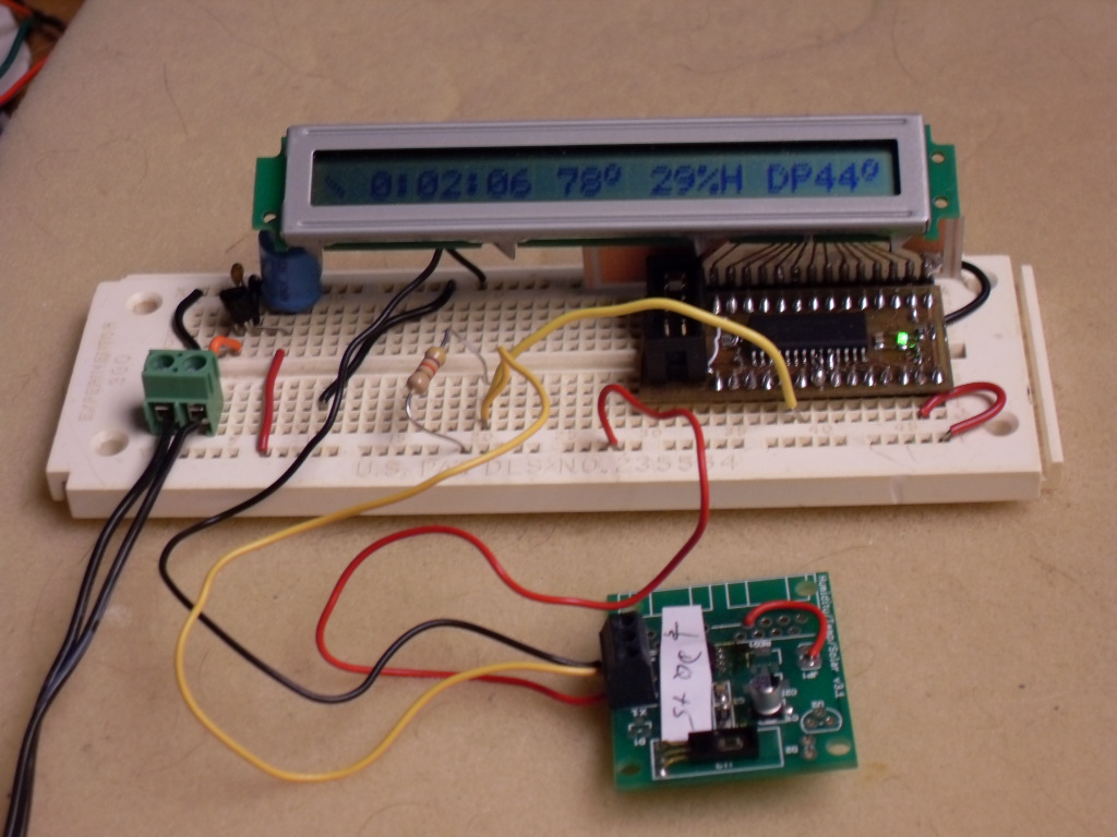

These are strictly for prototyping. It would be interesting to see how much smaller you could go with a QFN. Getting signals to the pins uses the major part of the board realestate. I do not think that using a chip with a smaller footprint will buy much if anything. Mabye better on a plated through PCB. I would like to be proven wrong.
On a 44 pin part I might look at having an onboard switch or two. Maybe LEDs to be used for status. But I do not like to add junk to the processor module. When any IO devices is fixed it often must be worked around.
The LCD in the picture uses all 12 bits along one side of the module. I was going to use hardware I2C but the I2C clock pin is on one side of the chip/module and data on the other. So I ended up bit banging it.
