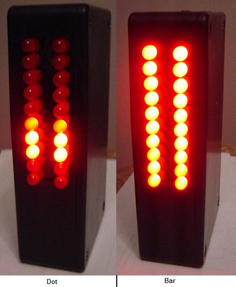

Hi Sean,
Telephones are all different and use nearly all the different types of microphones. You probably want an electret microphone that is very good, small and inexpensive. It needs a resistor to provide its internal jFET with a small amount of power. Then a preamp amplifies it and some LED driver transistors or an LED driver IC drives the LEDs.
I made and posted a project that is somerthing like what you are talking about. It is very sensitive so it picks up and displays the sounds of people talking in a pretty big room, TV sound, music or a pin dropped. It has 10 steps of LEDs (I used them in pairs) for a logarithmic loudness indication and has automatic gain control to shift its range to display loud sounds. I have it powered by a wall-wart and an internal rechargable 9V battery. Its display can be switched between being a bar graph or a moving dot.

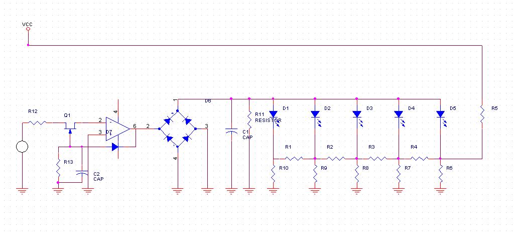

so this is the first thing i've ever designed, so take it easy on me......
The resistors at the bottom of the LEDs will be chosen to form voltage dividers such that each of the 5 diodes is harder and harder to turn on.
I put the rectifier in there but I think its making things unnessecarily complex. I think the lowest someone could talk is about 300hz, so after half wave rectification that is 150hz which is still twice as fast as the average human eye.
The microphone is represented by the circle. Most of the electrets I've been researching have an input and an ouput. Where do I power the jfet? which end is ground?
Any help would be appreciated.
EDIT: ooops i missed the op amp's feedback resistor. P.S. what op amp should I use? can I power it with just one 9v battery?

Hi Sean,
1) Your electret mic doesn't have a resistor powering it so it won't work. It needs a resistor to the power supply to power it then a coupling capacitor to the opamp.
2) Why is there a FET between the microphone and the opamp? It should be a coupling capacitor.
3) Why is the opamp an inverting circuit that has a very low input impedance instead of a non-inverting circuit that has a high input impedance?
4) What is the rectifier bridge for? 3 of its diodes don't do anything and the one diode that rectifies is creating a 0.7V voltage drop. You don't need a rectifier because the opamp rectifies by itself if it has a single supply.
5) An opamp doesn't have much output current so it can drive only a single LED brightly. You need a circuit with a comparator/LED driver for each LED instead of all the resistors.
6) The RC that tries to keep the LEDs lighted for long enough time to be seen is overloaded by the LEDs. The RC should be at the input of comparators.
7) The resistor ladder at the LEDs will reduce their brightness while reducing the level they will turn on.
You need an IC that is made to do most of your circuit. An LM3914 has 10 steps with equal voltages. An LM3915 has logarithmic steps and I used it in my project. An LM3916 is a VU meter but I prefer the LM3915. They have 10 comparators fed from a resistor ladder inside. They drive 10 LEDs. The ratio of 2 resistors program the amount of input voltage needed to light the highest LED. The total value of the two resistors sets the LEDs brightness.
I used MC33172 dual opamps in my project because their inputs can work at 0V when they have a single supply. The MC33171 is a single opamp and is available at Digikey (they are sold out of the duals). They work with a supply voltage from 3V to 44V.
A 9V battery doesn't have much power to light 10 LEDs for much time. The LM39xx ICs can be set to light a single LED as a "moving" dot to save power instead of many LEDs in a bar. My project has a switch to select which mode.
