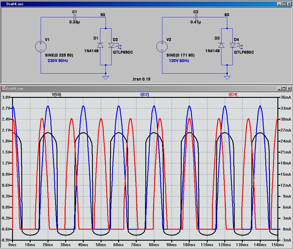

That's why it's best to use a 220n capacitor to limit the current.
See circuit - next posting.
If you add a diode to the circuit you will be consuming half-wave energy and if three 0.25watt resistors are connected in series for 120v, they will not get too hot.
If you use a capacitor to limit the current through the LED, you will have to put a silicon diode (1N4001 or 1N4148) in inverse-parallel with the LED. This is because in the capacitor, current flow must be AC, otherwise it will charge up and there will be no current. Note the two examples of driving the LED from 50Hz and 60Hz.
Of course, if your goal is energy saving, then you might as well use a second LED in place of the diode. For that matter, you could put up to 30 LEDs in series, and then 30 more in the opposite direction :D That would take a slightly larger capacitor...
Circuit suggested in post #18 has fewer parts, but if you're sensitive to 120 Hz strobing, the circuit in post #17 has a much smoother light output.
