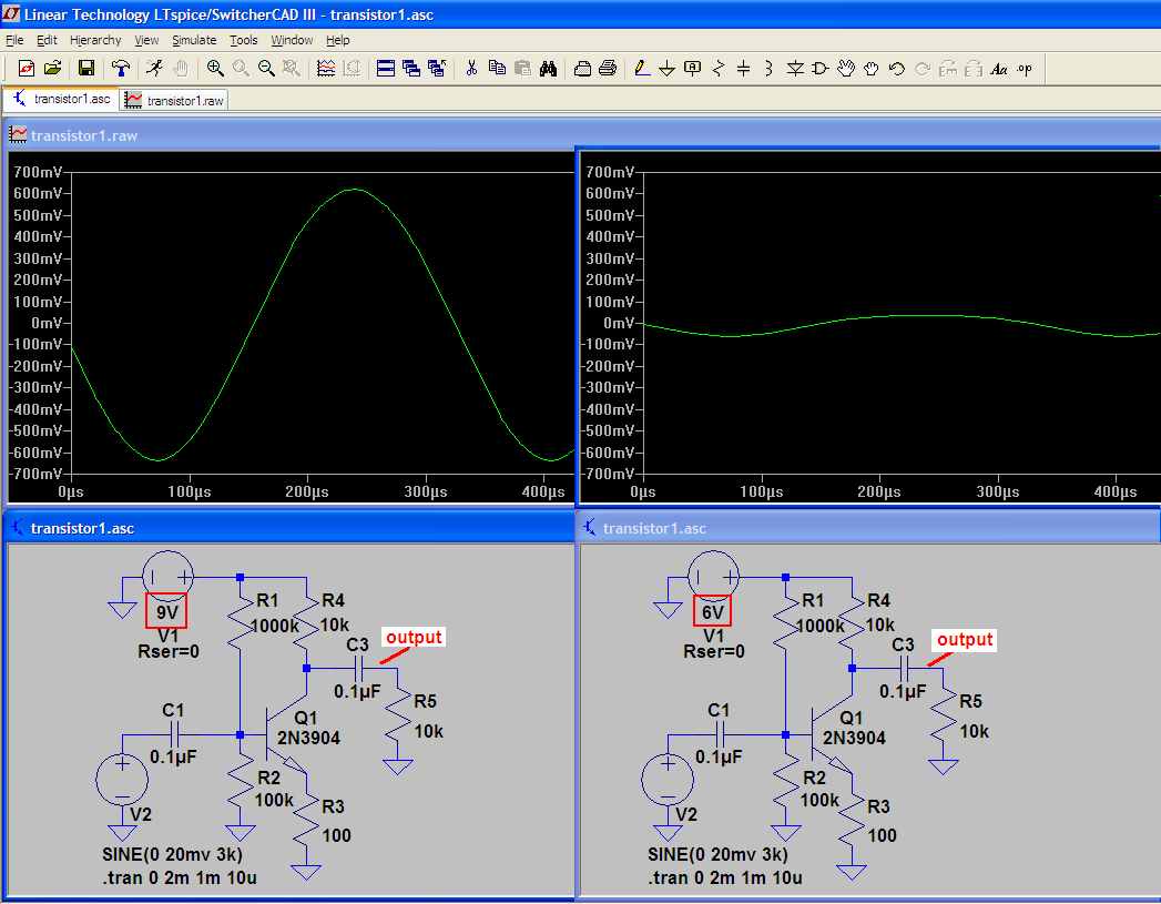

The simple FM transmitter circuit you posted has its antenna connected directly to its oscillator's tuned circuit. So its frequency will change when anything gets near or moves away from it.
It doesn't have a voltage regulator so its frequency will change as its battery voltage runs down.
It doesn't have a voltage regulator so the output level from its preamp transistor drops a lot when the battery voltage runs down. When the battery voltage is low then the sound is badly distorted.
It doesn't have pre-emphasis (treble boost) like FM radio stations have so the de-emphasis in an FM radio will cut the high frequencies and make it sound like your home stereo with its treble tone control turned all the way down.
Here is a simulation of the mic preamp transistor with a new 9V battery and when it has dropped to 6V.
