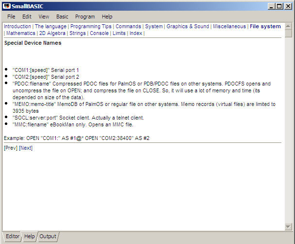

Mike said:
Is the serial port supported on a WinXP machine?
It appears to be in the latest version.
I ask because I get an "unsupported" error message when running the example 'chat' program on the open "com1:" AS #1 line in the program...
Regards, Mike
Still haven't figured out if access to the serial port works on WinXP machine... If I'm missing something that's obvious to one of you guys could you point me in the right direction please?
Thanks guys... Regards, Mike

COM communications seemed to always be a sore point for visual BASIC, It was near useless in VB3 and sort of fixed (but you had to load a module) in VB4. I've not used VB5 or 6 so I can't comment on them.
I used to use Turbo BASIC (still have it) it became Power BASIC. The reason I began to use SmallBASIC was to share simple programs in forums & on the web. Unlike compiled programs you could run them on any OS.
Perhaps one of the other free BASICs have COM support, I'd be interested in this also.
PS Mike. This odd program compiles, not sure what it does in SmallBASIC (no baud settings etc...)
open "COM1" as #1
print #1,"Hello"
close #1

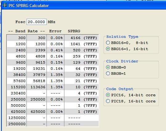

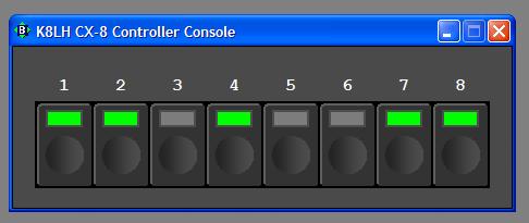

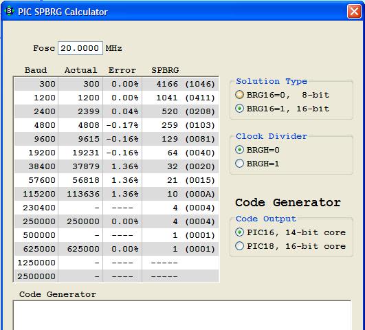

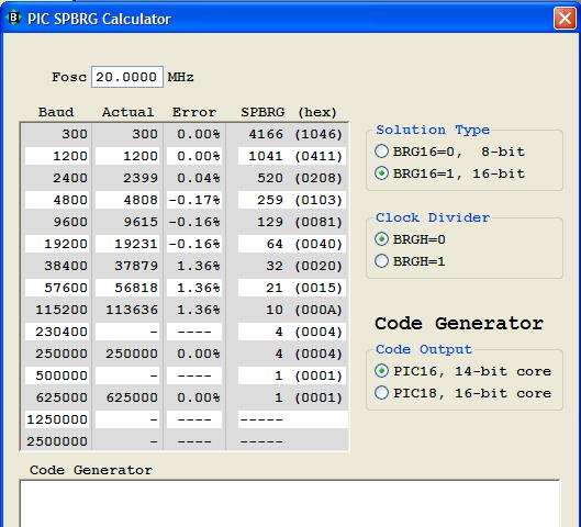

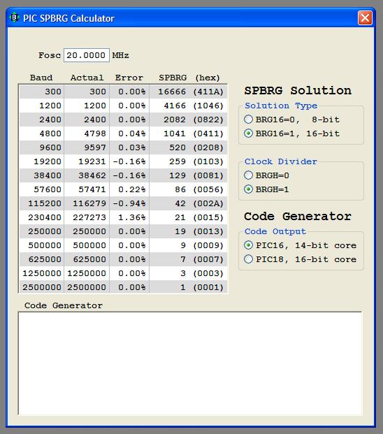

Hope you all don't mind me bringing up an old thread...
Just wanted to say thanks for the tip on the Just BASIC interpreter... I think it's gonna work out just fine, though it's a pain-in-the-butt trying to learn it without any type of written documentation (Help File and Forum only)...
Kind regards, Mike
