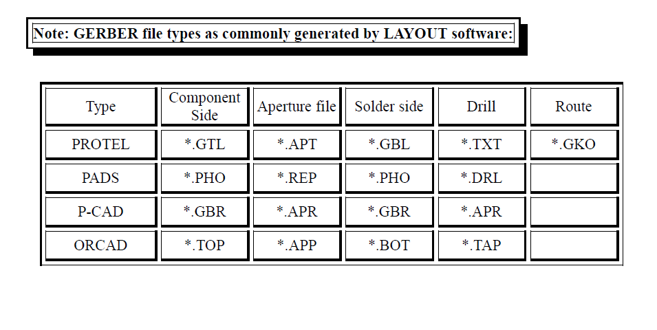

Hi i have recently got access to an Everprecision EP2002 PCB Machine.
The problem is that the gerber files that it accepts(as shown in the figure) are not being generated by Eagle. I did find out a CAM Script from Sparkfun
How-to: Prepare your Eagle designs for manufacture - Hack a Day
that does generate some of the files but not all the files. Does any one know how to generate any one complete set of files(as shown in the picture) using Eagle.

Yes, standard Gerber RS274D rather than RS274X which has the aperture file embedded. Can't help you, but searching for RS-274D and Eagle might help.
