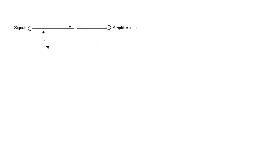

I have another question. how will theses capacitors in diagram interact with each other? the reason i ask this is that the signal im getting in is abit distorted.
The signal comes from an analogue sensor whos voltage chagnes with position of sensor i.e 0 to 360 degrees. if i turn the sensor anti clockwise the output of the amplifier is ok but then if i turn to Clockwise the output of the sensor is distorted a little?
The amplifier im using is a differential one who is ment to be giveing me the velocity of the signal. I hope this is enough information, i cant put the schematic up due to this being a work project.

The first capacitor to ground is shorting the signal which might cause oscillation, distortion or both. Why is it there?
Im not to sure i think its too clear the distortion from the sensor, the actual output of the sensor is not AC in a sense it dosent swing above and below ov, but it is a varying voltage from 0.6 to 5v? i think the idea was to reduce quantization noise from sensor to give a more smooth output.
I do not know what is driving the capacitor to ground. Many opamps would oscillate when they try to drive a capacitor to ground.
Could you please describe what you mean by drive to ground? ive heard this term a lot and im not entirely sure what it is. is it the fact that im passing the ac signals to ground? i.e driving them to ground if so then the sensor is driving it to ground?
Thhsnks for your help
"The first capacitor to ground" is connected to ground and maybe it is connected to the sensor, not to the output of an opamp. Then this capacitor is a filter.
