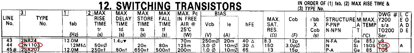

If you believe your own eyes, you'll see that a real 2n1103 comes in a TO5 case and NOT a TO92 case:
2n1103-png.26473
/www.allelectronics.com said:
MPSA06 transistor. Small NPN power and signal transistor. TO92 plastic package. This is a "house-marked" part, stamped 1103CA. Taped, ammo-pack packaging. 10 piece minimum.
What you received was in a TO92 case, right?
2n1103-png.26473
A 2n would be a National Semiconductor (Japanese) design, eh?
Why would you post anything other than that datasheet?

What makes you think that National Semiconductor is a Japanese company? Japanese transistors usually start with 2SA, 2SB, 2SC, 2SD, etc.
Why don't YOU post a datasheet showing the 2N1103 in a TO92 case? Your arguments will carry more weight then.
What makes you think that **broken link removed** is a Japanese company? Japanese transistors usually start with 2SA, 2SB, 2SC, 2SD, etc.
