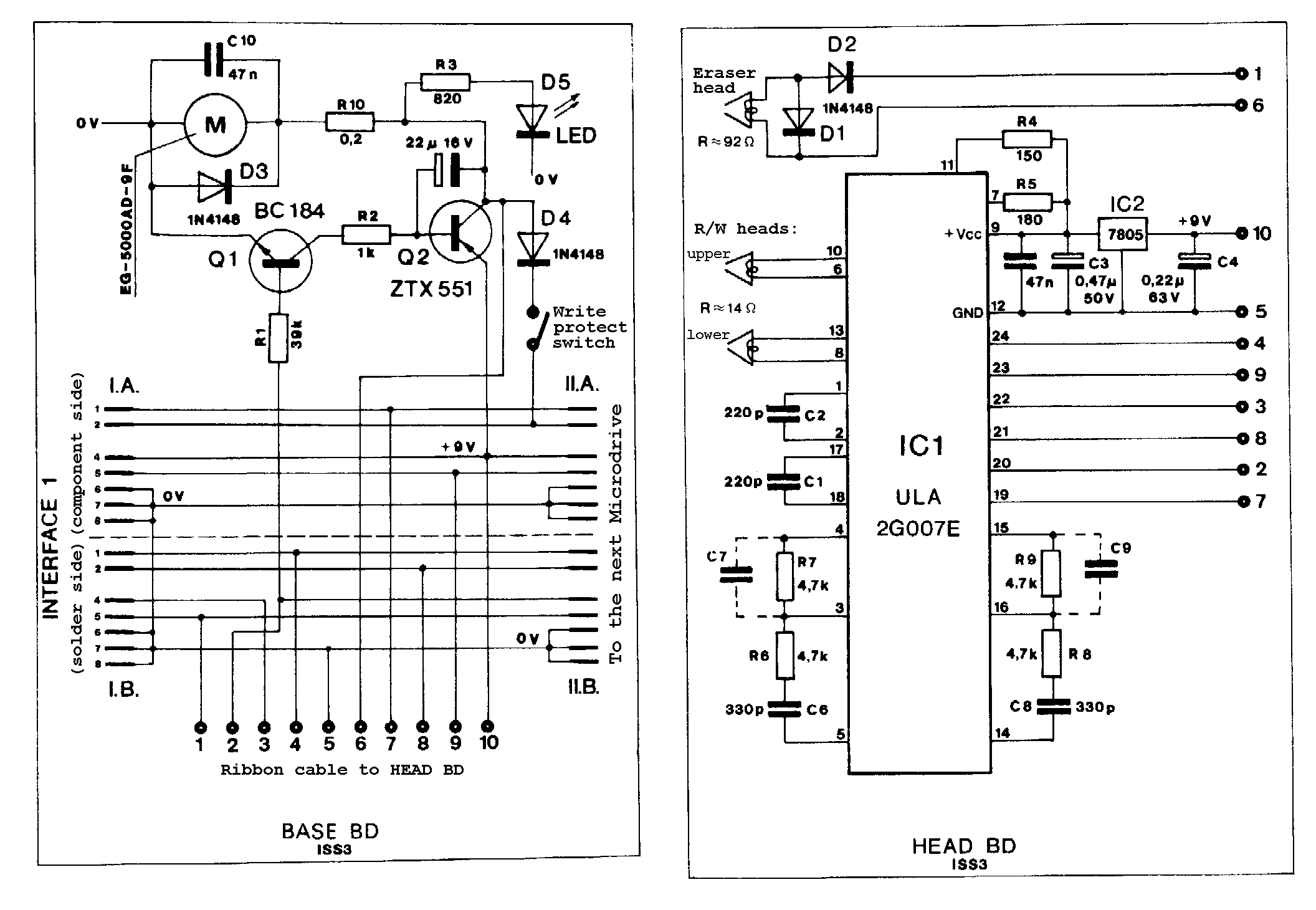

I want to interface a specific magnetic tape drive to a PC... I have looked aimlessly through countless pages, but not really sure what I'm looking for...
The tape is a microdrive used by Dr Sinclair way back when these were the dogs dodah's... I know tons already.. speed bits per cm.. data polarisation etc.. But I don't know, and seem to not be able to find out, the data format... I am assuming similar to cassette tape drives...
Dr Sinclair used ULA chips to do all the mundane stuff, so the old "black box" theory... The device in question is on my new...LOL new!! QL... I want to make a transfer utility....
