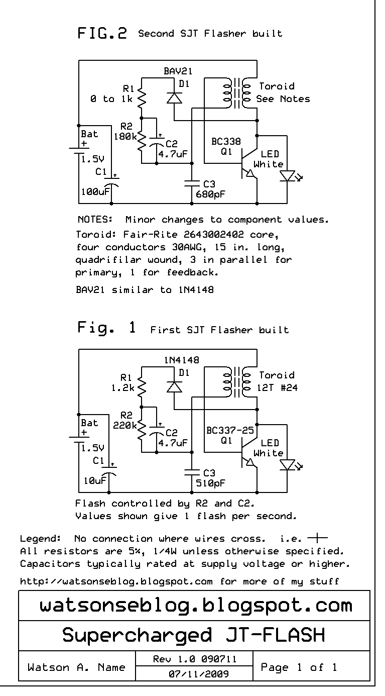

Flashing LED, plus a Joule Thief.
Note that you'll need a zener and capacitor across the LED to protect it from the high voltage when it turns off.
hmm, that suggests to me that a "flashing Joule Thief" might be simpler than the 3909 alternatives. Good project for 'tomorrow'. (errrr... that is, the other end of tonight.)

An LM3909 had a minimum supply voltage of 1.15V, not 0.5V. Then its LED was not bright. With a brand new alkaline battery cell (1.6V) then the LED was bright.
You might be able to use it in conjunction with a Joule thief but it's useless on its own because it requires 12V.
