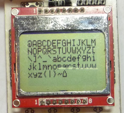

Anyone want to take a peek at example code to implement a 'packed' font array (table)? I borrowed the idea from a Gentleman over on the PicBasicPro forum.
My old 96 character 5x7 font table used 5 words of program memory to store 5 (7-bit) bytes of pattern data for each character and the entire table used 480 words of program memory. My new table packs two 7-bit patterns in each 14-bit memory word and uses three words per character for a total of 288 words of program memory.
This is a demo program for a 16F1823 and a Nokia 5110 display written in BoostC. I haven't tested it on hardware yet but it simulates ok. It's reasonably tight code (452 words total) but it's also pretty rude-n'-crude with only the simplest functions to write commands, data, ascii characters, and ascii strings to the display. I haven't even had a chance to add a clear-screen function.
If I have time I'll try to make an XC8 version of the program.
Cheerful regards, Mike

I also created a spreadsheet to convert my old 5-byte-per-character font table to the 'packed' 3 word format and added a crude single character viewer/editor, if anyone is interested. The packed output file can be formatted for assembler or C. I also added a 'Font Viewer' sheet to the workbook that renders the character set directly from the 5-byte-per-character input table.
Here's a version written for XC8 (and 16F1823). Much like the BoostC program in post #1, the low level drivers are assembly code. The program uses 370 words of program memory, including the font table. Some differences from the BoostC example in post #1;
() This version uses a smaller 240 word 96 character font table that packs 5 bytes per character of font data into 2.5 words of program memory.
() This version includes a clear screen function.
() This version drives the Nokia 5110 display using hardware SPI.
  • 16F1823_5110_v2.c

Yes, I have a 5110 display and both the BoostC program in post #1 and the XC8 program in post #3 have been tested on the display (Vcc = 3.3v). Here's the XC8 program running;
Looks good. I read the first few posts that you simulated it - nice to see you built a working version.
