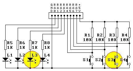

Hi everybody,
I am doing Nigel Goodwin's tutorials. Finished LED tutorials, and started Switches tutorial. I faced a problem and spent last week revising my work for any clear mistake. It repated itself in all the three tutorials 2.1, 2.2, and 2.3.
One of the switches and the corresponding LED turns ON whenever I switch on the power and makes no any response.
Attached Nigel's board on which I marked the Switch and LED. And this is the tutorial's link
and here is the first tutorial code where I added A into the list and config files since I am using PIC16F628A.

can any one tell me where I made mistake?

The code seems fine... I suspect a hardware fault that is a short with probably accidentaly grounded the respective switch port and check the switch?
or try this code and see if the same led still goes off...

Nigel Goodwin said:
If you're using an A series chip, you need to alter the config line from 0x3D18 to 0x2118
One more time you are CORRECT. I replaced it and it is working fine.
I tried it and got the same problem which shows a software mistake.
thanks for all

Push Sw#2... do test for Sw#3 or Sw#4
No user Delay states.
Do you follow this.?
i'm trying to save i/o's by using one switch for more than one function.
function.
You would save pins doing it this way.
Have you also considered using one or more analog inputs connected to a resistive divider chain connected between +5V and 0V.?
It would be possible to connect about 8 or 10 switches to one analog input.
The voltage level at the ADC input could be checked to see which Sw has been pushed.
