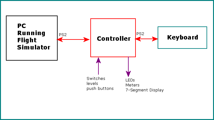

Of course the best is to emulate an AT keyboard using several pins of the PIC so that no change is required in running F/S.

I think the best solution is to emulate make and brake codes by MCU (PIC preffered 8) ). This site should help you interfacing MCU to PS/2 port on your PC.
The PS2 keyboard has a clock line and a data line. If data appears on the data line in correct timing with the clock then the PC won't know whether it is a real keyboard or a fake.
The method of how to put the keyboard scan codes on the data line is clearly explained on this site.
The PS/2 Mouse/Keyboard Protocol (**broken link removed**)
Using a PIC one can easily implement the above protocol and send any keystoke to the PC.

Hi Garry2005,
You have asked a lot of questions so I'll try my best to answer them for you.
Garry2005 said:
I don't even know which one (or ones) would be best suited for this,
The choice depends on how many I/Os you would need. The "bigger" the PIC, the more I/O pins they have.
Garry2005 said:
how they intrerface to the PC (or keyboard controller),
See image at bottom of this posting. You connect pins of the PIC to the PC PS2 keyboard socket, if the PIC mimic the keyboard correctly using software, the PC won't know it is not talking to a keyboard.
