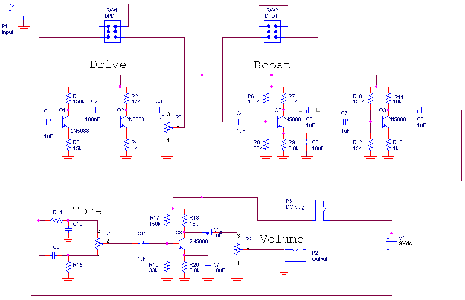

I have made this curcuit and would like somebody to take a look at it, telling me if everything seems right.
It is an effect stompbox for a guitar, one Overdrive/Fuzz and one Simple Booster.
At the end a simple tonecontrol and a master volume control.
The values of the tonecontrol Caps and Resistors are not defined, because I have not desided how the Tone sound is going to be.
Well, what I would like is you to see if there is any errors of mistakes in the schematic.

Well Q1 and Q2 won't work, they don't have any base bias.
Well, they will work, not making any clean sound, but destroying the waves from the guitar. This is the whole idea of this part, just destroying.
Feel free to make it like that then,but it will sound crap, if it works at all? - the required distortion is caused by overdriving the amplifier, not by leaving out essential components.

Oh, ok.. Well, I must say that i have been thinking of this solution, but I really like the sound of the 2N5088 or actually I'm planning to use the 2N5089, they don't use that much current.

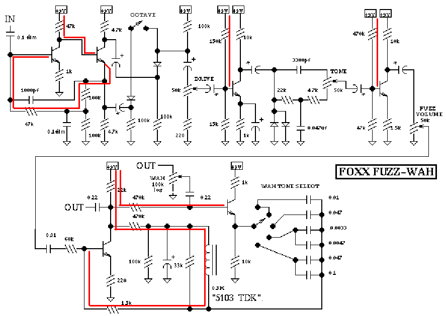

Regarding Nigel Goodwin, I'm pretty sure they will work, I have made some research and found a simulare circuit, with a little more to it, it's the Fozz Fuzz-Wah, **broken link removed**, as you can se the basics of it's overdrive part is the same.
The circuit in that link has all the transistors correctly biased, your one has no bias at all on the first two transistors - have you ever seen a circuit that looks anything like your one?, I doubt it very much (at least not a circuit that worked!).

I have marked the base bias current for every transistor on the linked circuit. Not a single transistor has no base bias current like Q1 and Q2 in XCrevil's circuit.
Transistors don't work without base bias current.
Hmm... Your actually right, didn't see the circuit that way, hmm, guess I'm going back to the drawing table :)
