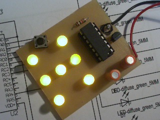

This was one of my early projects using pics, and I hope it will be helpful for any newbees. The programme is written in Mikrobasic, but should be easily changed to suit other basics.

  • CIMG0007.JPE
    CIMG0007.JPE
I wonder how loaded the dice routine is? What's the A/D routine for?

A/D routine is only a cheap way of reading the keypress, by looking for a volt drop rather than messing about with de-bouncer routines.
Ahh, well I was looking over your code and the die would appear to be "weighted" as rolling loop is not same the number of instructions when resetting the die counter.
This is a common problem with computer dice, the solution I found was to run TMR2 as a modulo 6, 36, 216 etc... counter as the rolls would be fair. Just like your version I left it to the human element as the random part.
I've written some test code in Swordfish BASIC for the 18F, I'd be happy to post it if you're interested.

It's still a loaded die roll. The problem is very similar to clearing a timer when building an RTC.
If an external switch debouncer is used surely you could get rid of that delay, and make it minimally loaded?
The program rolls (loops) hundreds if not thousands of times between button presses. The loading is caused by an asymmetrical loop, it's impossible to fix using loops in a high level language. You could fix it with an assembly loop and adding padding where needed to make every count execute with the same number of instructions.
The other method uses a self-resetting free running timer (compare)
