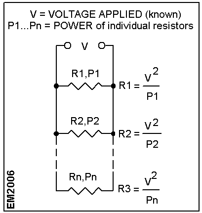

First of all, thank you to anyone who took the time to read my noob question.
I am a student and having a bit of trouble.
I am dealing with a parallel circuit and I was wondering how to find Resistance when all I have available is Voltage applied and the Power of individual resistors.
Any help is appreciated and again, thanks much.
Formulas
See Attachement.
