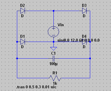

This circuit makes (LTSpice) ill. It is suppose to be a full wave rectifier with a capacitor to smooth out the ripple...It complains about the node to the right of the resistor.
If I remove the capacitor I think it works...
--Jerry

Right click on the diodes and pick a real diode model. I think the problem is the simplified "D" model has no resistance, so the capacitor looks like a short to the voltage source.

Thanks, I will give it a try. I also got it to work by changing gmin from 1e-12 to 1e-11 and using the "gear" integration method.

Every node has to have a path to ground, the diode model is probably open at some point. If you put 10 meg in parallel with the diodes, it will most likely work ok.
