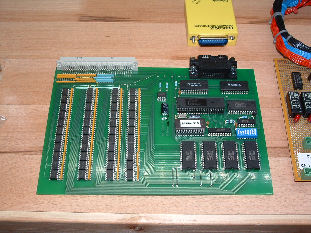

So one day I had a look on eBay and found a GPIB digital I/O board and bought it.
![Digital IO 64 Bit.JPG Digital IO 64 Bit.JPG](https://www.electro-tech-online.com/data/attachments/87/87081-8ef640797d67591ba2e0cad700fe2ed7.jpg)
64 bits, opto isolated, some inputs and some outputs, just the job.

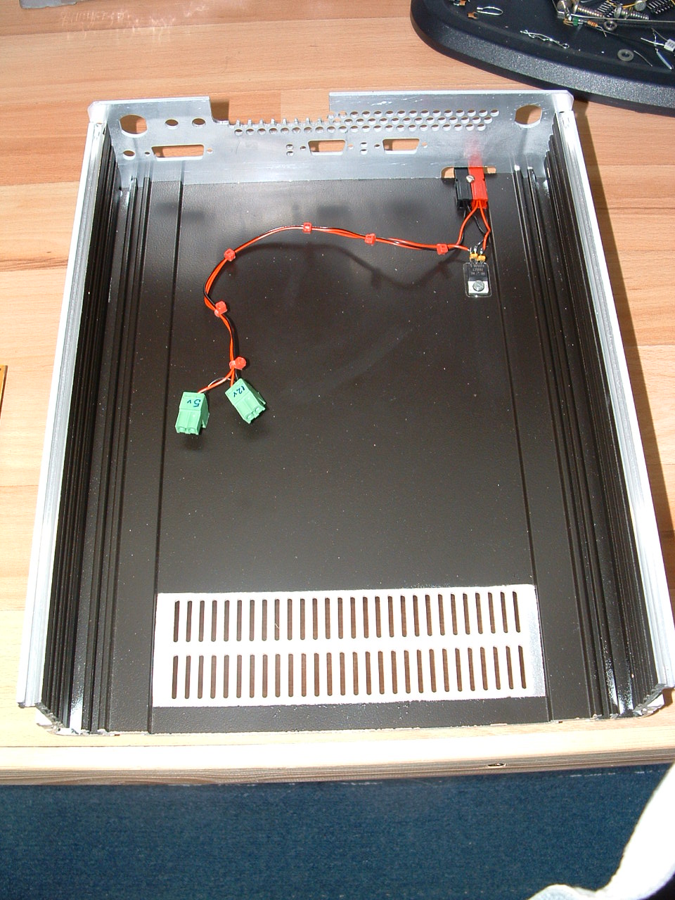

The next problem was how to mount the thing.
I had a cabinet with a rack which could be adapted to hold that card, I went as far as building it up and mounting a power supply in the case. But the problem remained of how to implement the connections to the outside world, and the case really was far too big. I even bought another case, but it was awkward to mount the card and again it was just too big.

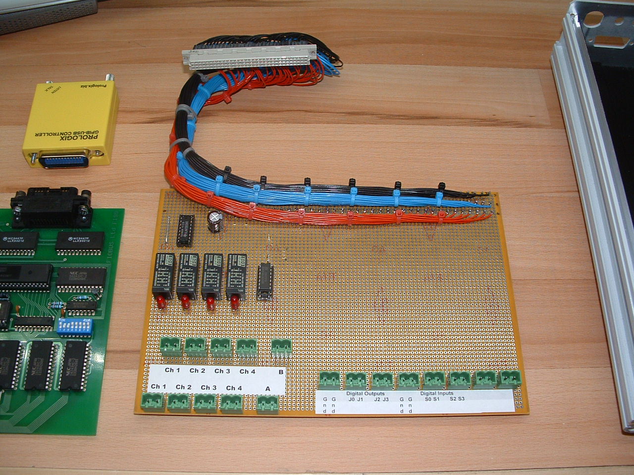

I bought a couple of prototyping boards of the same size as the digital I/O board, and some relays and connectors, but what to use for a case?
One day I was idly looking at a pile of junk under a table and realised that I had a nice case which had contained a satellite modem (I had bought the modem very cheaply for bits).
Even better, the DIO board and the proto board fitted exactly into slots in the extruded alloy case.
So, I built up an I/O interface board with connectors to the outside world, relays for the DMM and Counter multiplexer, a couple of integrated circuits for logic to drive the relays, lots of wire to connect to the digital I/O board, and the result is this:
![Connector and Relay Board.JPG Connector and Relay Board.JPG](https://www.electro-tech-online.com/data/attachments/87/87082-4ed64ccc4ab3460ebe1a570b232c545c.jpg)
Put a three terminal regulator for the +5v supply into the bottom of the case, (makes for a good heatsink).
![Case.JPG Case.JPG](https://www.electro-tech-online.com/data/attachments/87/87083-a67ebf62b77a53ea7ce59f42be71865f.jpg)

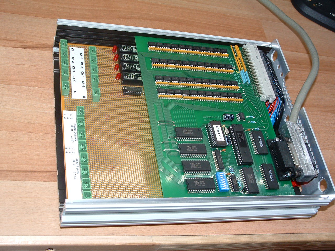

Assemble the whole lot and it looks like this:
![Inside View.JPG Inside View.JPG](https://www.electro-tech-online.com/data/attachments/87/87084-96e58b0008f9a1e08c551b88115cee22.jpg)

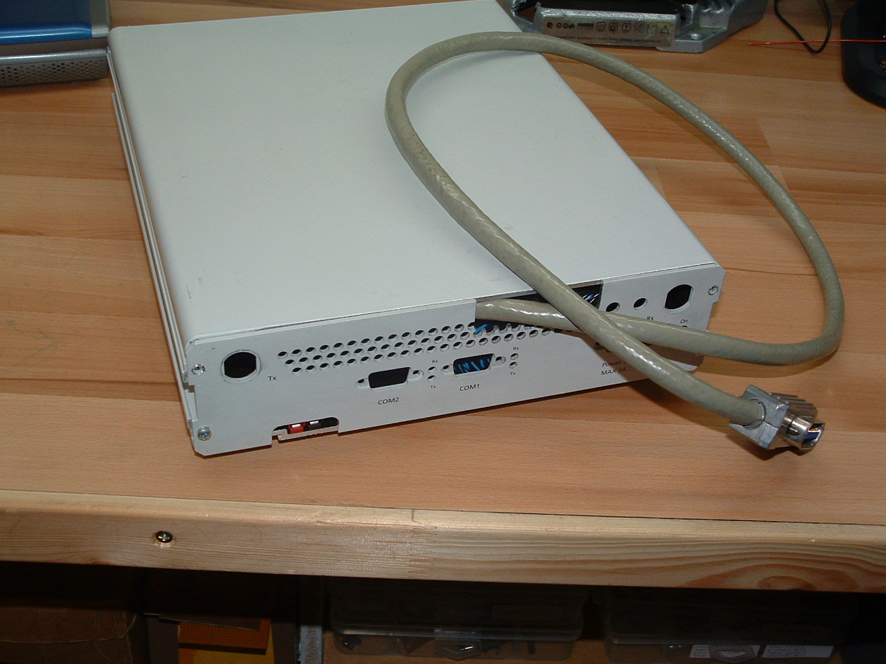

The cable snaking off out the back of the case is a GPIB cable. They are a bit odd if you have not seen them before, the connectors have both plug and socket so that they can be stacked to allow the cable to daisy chain from one instrument to the next.

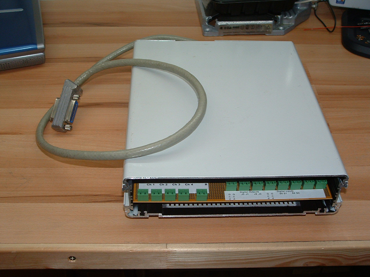

Put the lid on and the overall appearance is as we see here:
![Rear View.JPG Rear View.JPG](https://www.electro-tech-online.com/data/attachments/87/87086-eb2521a63720c76ff131a1e5ae54d3ec.jpg)
I did not put on a front panel because that is where to connections to the equipment under test come into the box through the green connectors.
The top of the case is not fixed, it will easily slide off to allow access to the inside of the box, should that be necessary when making the test connections.
So there it is, that is what I have been doing for the past two years since I first thought about it.
