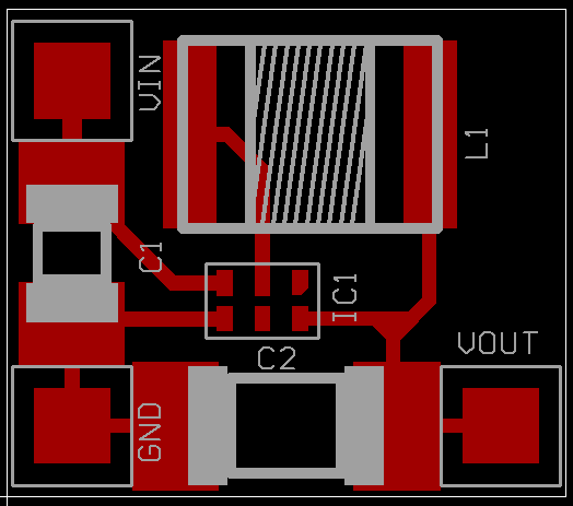

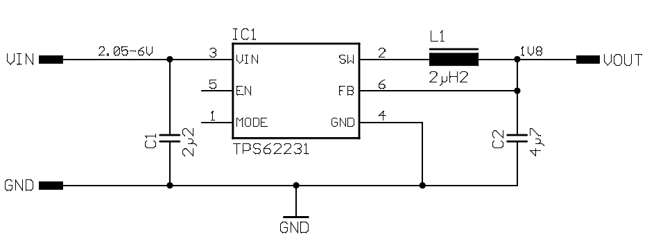

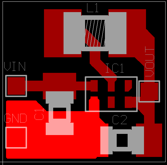

Here are the schematic and PCB design. The PCB measures 7.4X6.5mm.

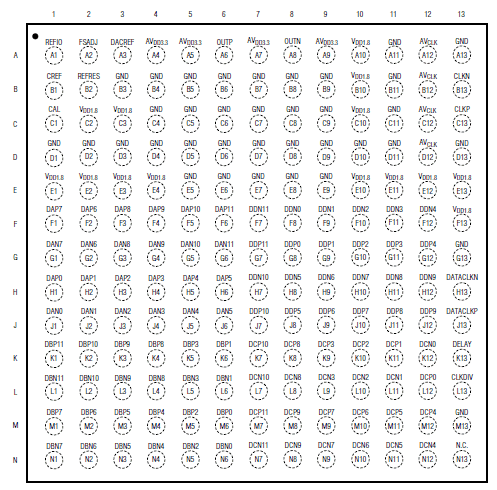

Here is a chip which will cause nightmares trying to manually solder it into place.

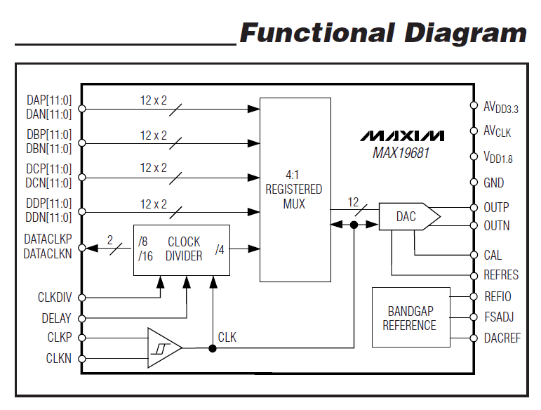

It's a MAX19681, a DAC with 4 (channels) of multiplexed 12-bit LVDS (low voltage differential signal) inputs at 375MHz.
It comes in a 169-pin CSBGA (compact size ball grid array) package. Chip dimensions are 11X11mm. :D

There arer a few problems with the layout, remember this is a 2 MHz switching converter, all parasitics are critical...
- IC1 should be closer to C1
- Traces should be thicker
- GND should be a copper pour (same for input, output, and SW) or at least thick traces
- board area could be halved by placing the inductor on the other side
- feedback is not taken from the proper point (after C2, not before C2)
- unshielded inductor will radiate
- no ferrite bead on input, so input wire will radiate
- no ferrite bead on output, so output wire will radiate
Sorry ;)
Sorry ;)

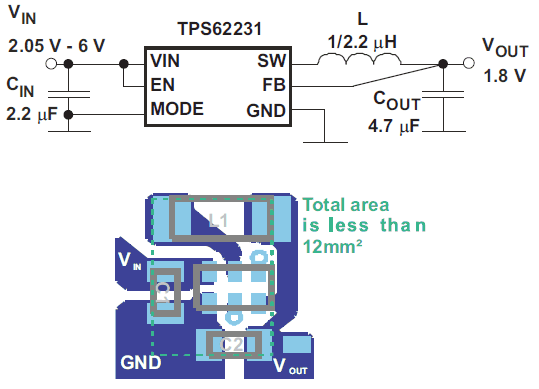

you might want to compare the board design with the original TI design.
The feedback IS correct.
TI doesn't use ferrite beads either. I guess their engineers know what they are doing.
Using smaller size components my design uses 22square mm instead of 12 (TI).
No reason to be sorry.
Yep, the TI design looks good, more copper and shorter loops.
For switching converters you need to draw (or imagine) the 2 loops the current will go through when switch is open or closed :
1) GND - Cin - top switch - L - Cout - GND
2) GND - bottom switch - L - Cout - GND
And try to minimize loop area of both, inductance before the switches, and capacitance to GND of the SW node. That's about it ;)
In fact I was suggesting to take it after the cap (instead of before) to reduce the noise, and increase output voltage precision. But the traces are so short that it may not matter at all.
Their layout sample is a part of a bigger board, so if Vin and Vout are planes, there's no problem.
Your PCB looks like a little module that will be connected using wires (ie, antennas), in this case some ferrites can save lots of headaches. Nothing fancy, a $0.04 murata BLMP or similar...
Also if you use wires, the small Vin pad can easily be ripped off the PCB. Copper islands are more robust.
