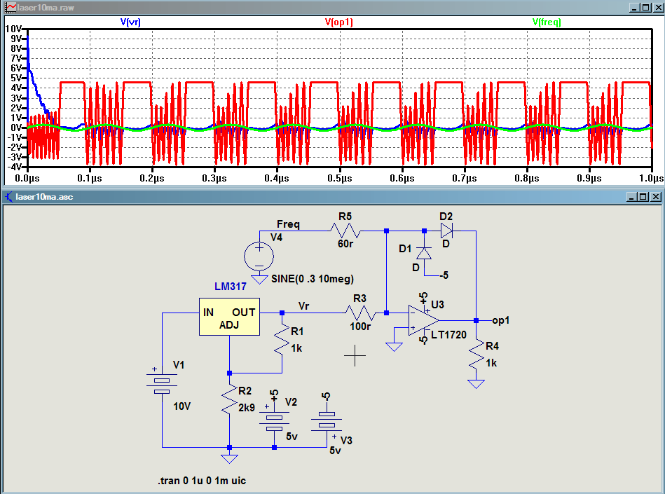

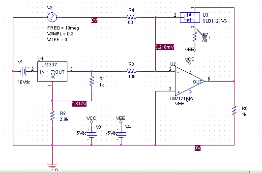

Hi everyone,I'm new here and this is my first thread.
I'm recently undertaking a laser ranging project,using phase-shift measurement.I was trying to directly modulate the laser beam of a laser diode using a sinusoidal wave with frequency around 10MHz and then build a receiving circuit to convert this modulated beam into an electric signal.I have already built an emitting circuit here,injecting a bias current together with a modulated current into the diode.I'm always trying to make the circuit as simple as possible so as to reduce mistakes,since i don't have a good circuit design sense.As for the receiving part,my basic idea is to use a PIN photodiode followed by a pre-ampifier but i find it hard to capture the modulated signal.I don't know what's wrong here,but the desired signal just won't come out.Could you give me some advice on that?Thx

hi,:)
Do you have a datasheet for the SLD device.
Is the circuit at this stage just a 'simulation' or actual circuit that dosnt work.?
This is the simulation in LTspice.

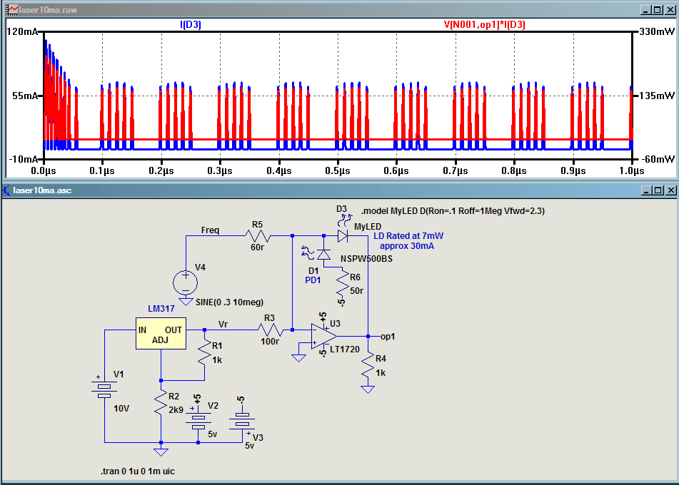

The sim indicates that you are over driving the LD.
Use the PD in a feedback loop to control the max current thru the LD.
If you have a spare LD/PD module, use the PD section in a receiving amp to detect the output from the master LD.
LT Spice, is the free lite version of PSpice.
