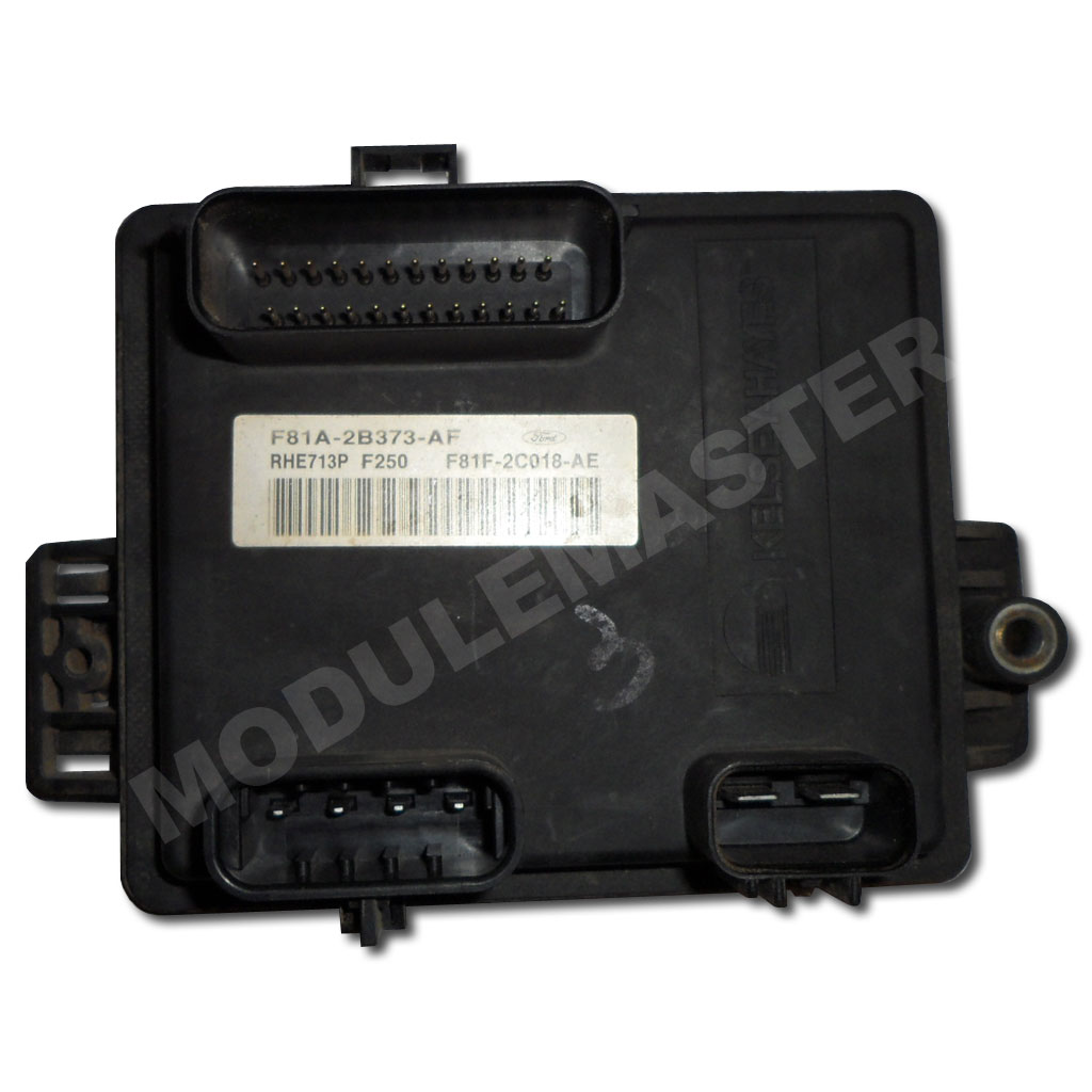

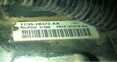

This the module but mine is a different number, second pic is mine. Kelsey Hayes is the MFG.
I had it scanned and it is a C1185 code. C1185 ABS power relay output. I called the Dealer and he was helpful but said it 99% that it need replaced.
