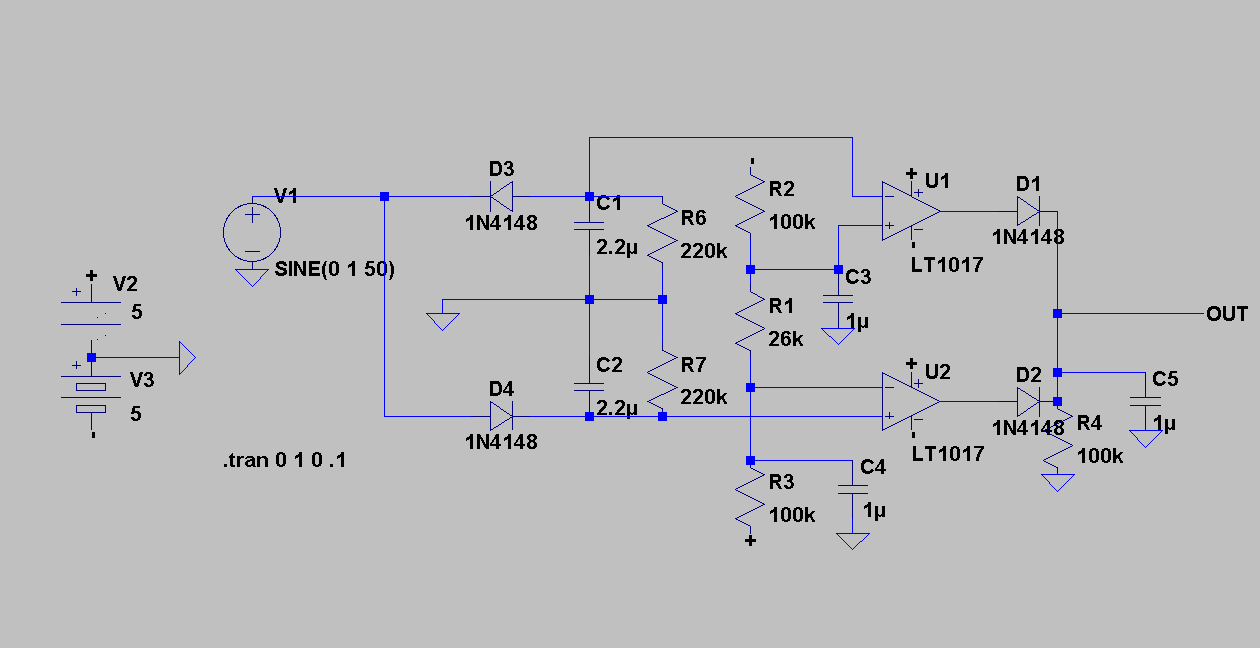

After spending far too many hours trying to cobble together an absolute value peak detector with a full wave precision rectifier, which would work up to 1MHz, I gave up on the precision rectifier part (which isn't really needed since I just want to detect input voltages over 1v ± peak) and did this way instead. One comparator is triggered if the input is over +1v, the other if it's under -1v. R1 would be adjustable in real life to set the threshold. I've tried simulating it down to 10Hz and up to 1MHz. The output is rather rough at low frequencies and the response time isn't very good, but it about does what I want it to do.
Can anyone help me improve it? I would like:
*Better symmetry when using real-world resistors
*Faster response to changes in input voltage
*Some proper hysteresis. Once the output has gone high, I don't want it to just follow the input when it drops a little. C5 provides the effect to some extent but real hysteresis would be better, since logic level output is lost when the input amplitude varies at 1 or 2 Hz - it needs to be immune to amplitude drops below the threshold down to about 0.5Hz. Increasing C5 makes the overall response too sluggish. Hope that doesn't sound contradictory!
*Neutralising the diode drops of D3 and D4 would be nice, but speed is more important.
*Not sure yet, this might actually need to be a window comparator
Thanks in advance, as always :)

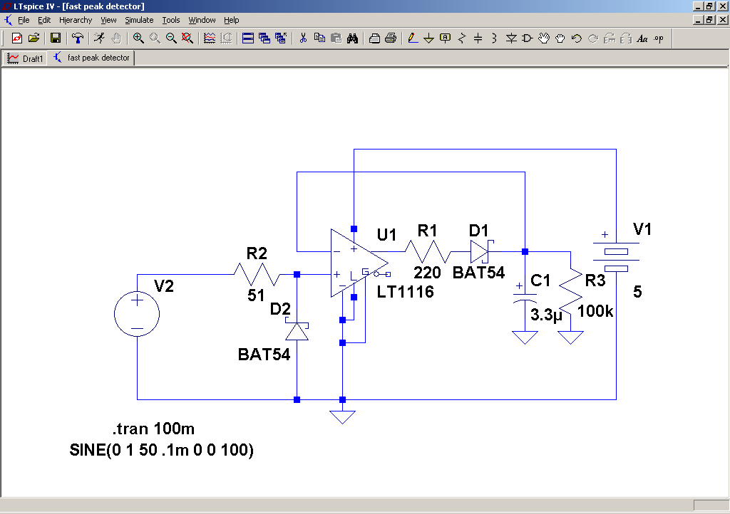

Thanks ronv - that's a really good replacement peak detector - I just need to make one for the negative half cycles! Can I ask how you arrived at the values for R1 and R2, and how you chose the schottky's, please?

I thought maybe you were using a signal generator or something like that so I just picked the 51 ohms. It also served to limit the current on the negative 1/2 cycle. The other resistor is just to limit the current for the op amp. Probably not needed since it is just a cycle or 2. I picked the BAT54 because they have almost no reverse current so don't discharge the cap when the comparator turns off.

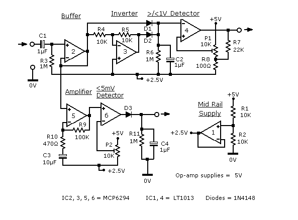

Here is an alternative circuit, combining a 1V level detector with a <5mV detector.
As the requirement was for operation up to 1MHz, then a 10MHz quad opamp has been used for the amplifiers. A less capable dual amp has been used for the DC stuff. The circuit runs from a 5V single rail.
IC1 is used to obtain a half-rail supply for biasing of the amps. Ic2 is used as a buffer. IC3 inverts the incoming signal. D1 and D2 pass on the the positive and negative peaks to the detector IC4. Allowing for the voltage drop across the diodes, P1 will need to be set at around 350mV above half rail. R7 and R8 give a degree of positive feedback to give about 20mV hysteresis. R4 may need a few pfs across it to give compensation up to 1MHz for the input capacitance of IC3.
IC5 gives a gain of just over 210, so 5mV input will give 1.068V, and P2 needs to set to that value above half rail.
The circuit has not been tested or simulated, but should be a good starting point.

Far better than anything I was likely to come up with - thanks very much for that - single supply too - at this rate my split supply is going to become redundant! I will be firing up LTSpice shortly...
Can I ask why you chose the MCP6294 - was it just the gbw/quad combo, or what you happen to be familiar with, or were there other reasons? I ask because I'm still getting to grips with opamp selection, and going through the parametric searches of several manufacturers is quite tiring!
Very grateful :)
No, I haven't used it before. I saw you wanted to use it with the LTC1968, which operates with a 4.5V to 5.5V supply, so thought this circuit interface easily to it. You also wanted to measure signals up to 1MHz, so I Googled for '10mhz op amp single supply'.
Then I went through the list for various suppliers, and came up with that one by Microchip being sold at a reasonable price.
