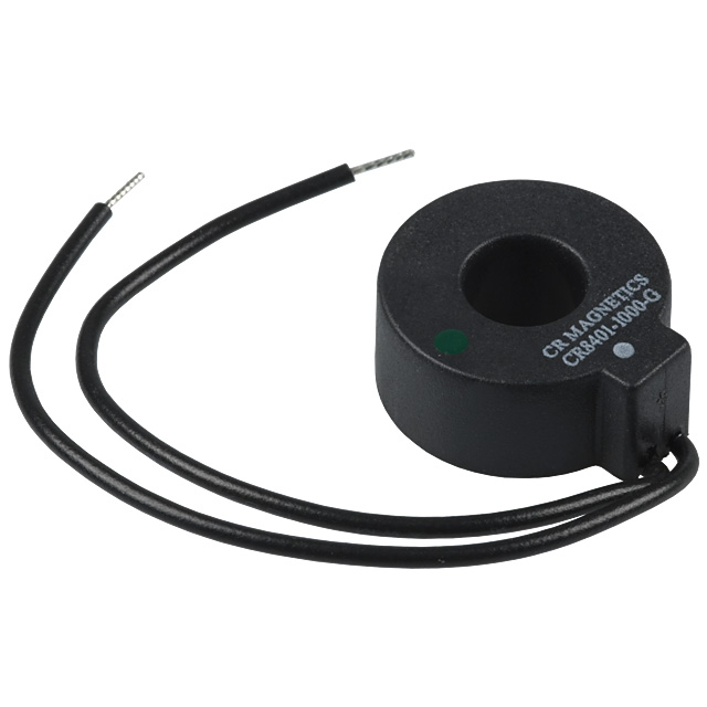

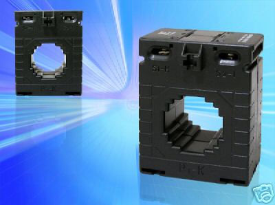

I was hoping that someone maybe able to point me in the right direction here. I would like to Measure AC current to determine the power usage of a circuit. The current I am looking at is from 0A to 5A, at 120V AC. I have found several current shunts that will do it, but I was hoping to do it without a shunt resistor. I have found current loops like the one attached. But this one also measures upto 50A, and I only need about 5A. I am looking at making this as small a possible as well.
Any Ideas or places to point me to research this??

Ok...now that I found the part I would like to use...the CR8401... I sort of know I have to thread the Hot side of the AC power through it and it generates an AC signal right?? I would assume that signal is proportional to the current running in that wire that is going through its core right??
If that is the case, I would like to measure that with a PIC's Analog to digital converter, so I would assume that I have to run it through a diode bridge of some sort to convert it to DC right??

It is indeed a "Current Transformer" thus it generates a current which is a mirror of the current going through it's center. The transformers are designed to generate a voltage across a relatively small value load resistor which is determined by the transformer's turns ratio and design (too high a value will reduce accuracy). The AC voltage accross this resistor can be measured, or you can meaure the winding current with an AC current meter.
You can not directly rectify the transformer current to get DC but you could amplifiy and rectify the voltage across the load resistor. For best accuracy you would use an RMS IC which converts the AC to a DC voltage equal to the RMS value.
CAUTION: Current transformers are not designed to work into a high impedance and can generate dangerously high voltages if their outputs are open.

Rectify it using a true RMS rectifier, and measure the voltage. You need true RMS as many items (switch mode units etc.) don't produce consistant sinewave currents in the supply.
So you are saying, use a unit like this one: AD736 and then the output of this chip can connect directly to the PIC ADC port right??
So a higher RMS voltage would equate to a higher RMS current of the wire being measured right??
Yes, something like that IC - to measure the current you connect a load resistor across the output of the transformer, and then measure the voltage across it (simple ohms law). Higher the current the higher the voltage across the resistor.
