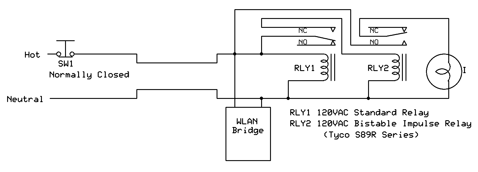

sorry it took a while for me to get this posted but here it is, its quite a simple drawing, but i hope it makes sense.
the latching relay should switch in the absense of current, and it does, but not regularly. the pause is just too short.
the solution i seek would be to have a reliable system where the light is turned on and off by a normal looking wall switch but the other stuff is not effected.

So... you want to always maintain power to the "wlan bridge", but be able to switch the light on and off? How long can the power be removed from the "wlan bridge" before it is stops working...your brief pulse width?
Ken
yes, and power can be removed for about 1/2 second without problems. an extension cord would get in the way, and wouldn't look very nice
OK, here's a shot at it. This is based on a standard relay and a bistable impulse relay. The closed switch powers the bridge and RLY1. The when the switch is opened, RLY1 is turned off, "making" the contacts that power RLY2 on. This toggles the contacts of RLY2, turning the light on or off. When the switch is closed again, RLY1 is powered, cutting of the power to RLY2. RLY2's contacts stay in the last state, holding the light on or off. The next off-on cycle of the switch will change the state of RLY2 and the light. This all depends on how long the bridge will operate with no power, and how fast the relays can switch. This is just conceptual, as I've not tried it. The Tyco impulse relay is about $25. Is that within your "experimental" budget.

I am going to guess that "WLAN" is a wireless lan.
Have you considered increasing the value of the smoothing capacitor in the wlan ?
Enough to ride out the brief absence of power.
