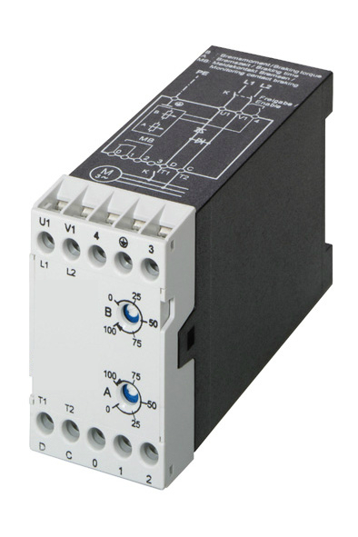

An induction motor has no inherent magnetic field - the fields are produced by current in the stator and induces current in the rotor.
To ensure a strong field and good braking, DC can be applied across two phase connections after the AC supply is disconnected.
The third phase connection can be shorted to one of the others (so part of the stator winding is directly shorted), or connected via a resistor or capacitor to regulate the current in that phase.
Another means of braking with a 3ph motor is 'plugging' or reversing two phases, it was popular at one time, but can be hard on the mechanics.
