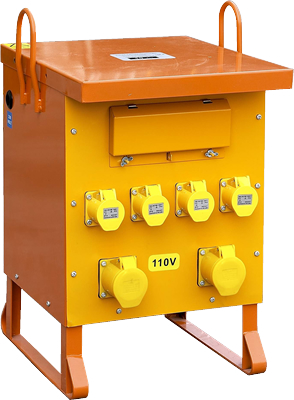

For the induction hob, you could use a 240V to 120V (or 230V to 115V) autotransformer.
The half voltage tap would be the virtual neutral. Not cheap, but cheaper than a dual wound transformer.

For the other conversions, wouldn't one larger unit be cheaper than multiple smaller ones?
Also, try doing a google image search for each appliance - there may well be versions from the same factories (possibly sold under different brand names) that are intended for EU use?
I'd expect things like the igniter and hood should be OK on 50Hz, just with a small 230V/115V transformer.
The microwave could possibly have a 230V transformer fitted in place of the 115V one, by an appliance repairer?
And the refrigerator may be OK on 50Hz if it's an inverter type, just needing an autotransformer or stepdown transformer.
Otherwise, a refrigeration engineer could probably also replace the compressor in that with a 230V 50Hz one, so again just a small transformer for the electronics power, plus possibly an extra relay to switch the 230V to the compressor.
Not the types of things you would do to new appliances in warranty, but I doubt any warranty would be valid once they were exported??
Industrial power tool "Site transformers" are likely the cheapest form of high power stepdown ones for simple 230V > 115V voltage conversion - the typical yellow box styles. The output from those is centre tapped to earth.

Basically looks, size and price. While it is possible to get native 240/440 stuff in German that is both adequately sized and looks nice, it runs around 150-300% more money than simply grey-market importing a US device.
I don't have a problem spending a lot of money on this remodel, but I cannot justify burning it.
The fridge is low power and the Power Xchanger does the job I need it to - despite its high pricetag.
The downdraft ventilation system and microwave are also low power, can share a Power Xchanger.
The ovens we want share literally 99.5% of their part numbers between US and EU specified models and the parts to convert it over are less than $1,000.
Dryers will be gas as trying to reconcile the 120/240 requirements isn't worth the time or effort, seems like the cooktop is the same as well. Just go with LP and be done with it.
Coffee Maker and Dishwasher will come out of the EU as the US/EU ones are basically the same.
