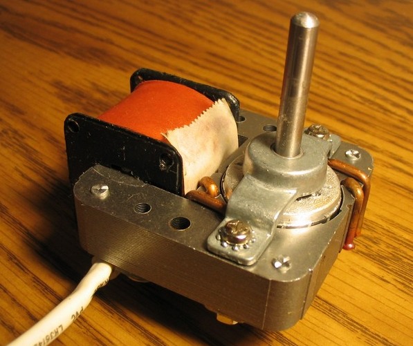

Why does adding a capacitor in series to an AC motor increase its speed? The capacitor does boost the voltage somehow because the input voltage is 132v (mexican mains) and coming out from the capacitor are 230v. This has to do with the inductance because it wont work without the motor. I made it, photos below:

Somehow you are affecting the frequency, an induction motor, especially a very inefficient type such as shading coil type, operates on frequency, Not voltage.
To what degree does the RPM increase?

Little shaded pole induction motors are not very efficient and there will be a lot of slip from synchronous speed. Increasing the voltage may reduce the slip and increase the speed a bit. The OP didn't say how much the speed increased.

The speed increased around 2 to 3 times. It’s certainly way faster and it hums more
An induction motor ALWAYS runs at a slower speed than the synchronous speed, a phenomenon called slip.
The only way that an induction motor could run 2 or 3 times faster, is that the capacitor with the motor’s inductance tunes it to the powerline’s 2nd or 3rd harmonic.

Are you running from the mains electricity or from an inverter? Some inverters have a larger harmonic content. You can't assume that the mains creates a good sinewave.
Can you measure the voltage across the motor when the capacitor is in place?

Im running it directly from mains. The sine wave looks acceptable on oscilloscope.
I did measure the voltage, its 234v. Mexican mains is 129-134v
It's certainly possible get an increase in voltage that large with a capacitor.

Luckily i still have 3 more AC motors. Here i used a different motor from a space heater and a 2.2 uF capacitor. This gives 184v.
One flaw though is that the original wire from the motor broke and it would keep breaking a lot, so I put the coil wire to the chassis/core and i used it as one terminal, so now it’s live at 184v and has a non polarized plug.

Yeah i know it looks like a cap start motor because its got two windings but its not, it did not have a start capacitor in the space heater. The capacitor was added by me to boost its speed. Here it is with the orange capacitor
Operating the motor above it's rated voltage by whatever means, will saturate the magnetics and greatly increase the current, leading to overcurrent failure (as you observed).

It failed because I accidentally dropped it and damaged the rotor. And i reutilized the wire to make a transformer.
