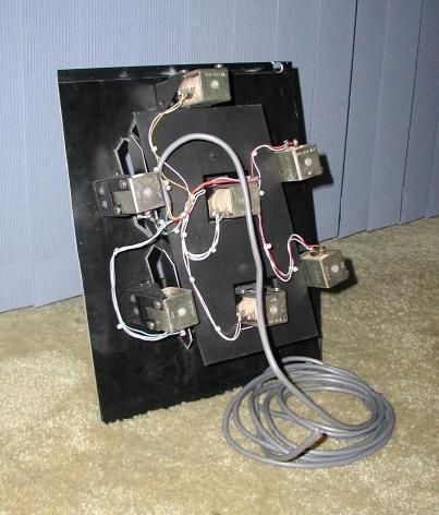

I acquired a seven-segment display that uses solenoids to power the segments. Not sure if they are AC or DC, nor the operating voltage. The voltage I can figure out by experimenting, but I don't know if I should be applying AC or DC. Any suggestions on how I can find out which is correct? Thanks.

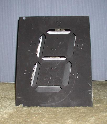

I guess a couple photos will help a lot. As long as a solenoid has power applied, the segment mechanically moves and covers the hole in the mounting plate. When the power shuts off, the segment springs back and there is no longer anything covering the hole. This is part of a 1960s vintage piece of equipment that railroads used to display axle counts at a wayside defect detector (I have only one of the three digits).
