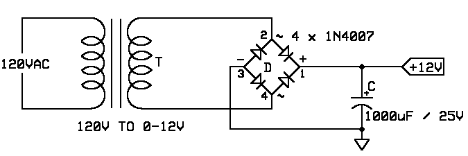

You are right. Rectifier converts AC to DC.
Following schematic is that of a siple bridge rectifier with capacitor filter. With this you can get good ripple free DC output.
For still better and regulated +12V output use voltage regulator IC like LM7812.

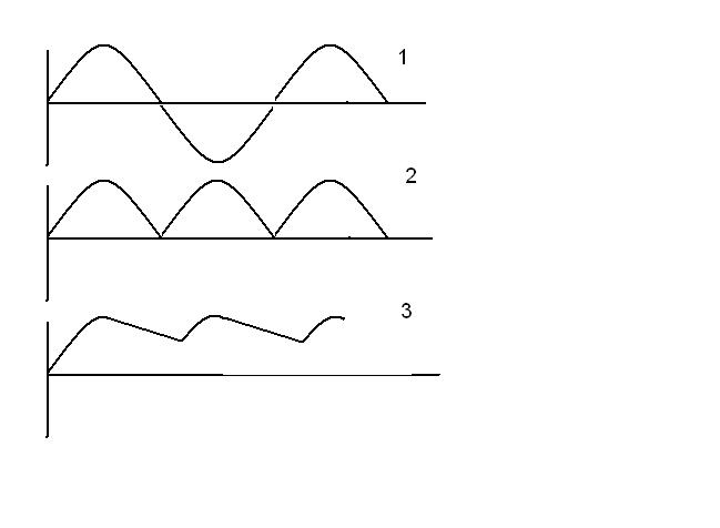

How can a capacitor smooth the DC Signal? I know it's better to put it in parallel with the output (that's the way we learned it in basic electronics) but why?
Say you have a AC voltage like in figure 1
The bridge rectifier will cut off the negative side of this sinus and put it on the positive side (figure 2)
This is DC, but as you can see, a bumpy one
The capacitor will get charged at the moment the sinus is at it's peak and discharge itself when the sinus gets smaller again. This way it "fills" the holes in between
sorry for the bad drawing - done in a hurry
Actually I thought it was a pretty good drawing, explained it well!.
One point to mention is that the degree of smoothing depends on the size of the capacitor, the current drawn from it, and the frequency of the supply.
The capacitor acts as a simple battery, providing power when the rectified AC voltage drops - a capacitor is defined as:
'A device for storing energy in the form of an electro-static field' - that comes from a LONGGGGGG time back :)
Thanks for all your replies :D One Last Question How Do U Figure out what size cap u need for any applacation is there a math formulae?
I'm going to make a few reasonable assumptions here:
1) You are in fact using 120V 60Hz voltage as your input.
2) You are indeed using a bridge rectifier as shown above.
3) Maximum load current is going to be 1A (this is the max you'd get from a 7812 regulator)
Looking at the data sheet for the 7815 (https://www.onsemi.com/site/products/summary/0,4450,MC7815A,00.html) we see that it has a dropout voltage of 2.0V typical. We're going to add a margin of safety here, and make sure that we're always going to be above that threshold by having a minimum input voltage of 16V.
Since 120V is an RMS voltage, we need to convert it to a peak-to-peak voltage by dividing by multiplying by sqrt(2). If you really want to understand the math behind that, use google, otherwise, assume it to be true. This gives us approximately 170Vpp coming in from the wall.
If we get a 9:1 transformer, this will give us 18.8Vpp coming out of the secondary. We then have to take into account the voltage drops in the dioes, which for a bridge rectifier is 2 * Diode Drop. For silicon diodes, Vdrop=0.7V roughly. This means that we're getting around 17.4V
If we have 17.4Vpp coming from it, and we want a minimum of 16V coming out of our rectifier, then our Vripple = 1.4V. This gives us all the variables we need.
Note: Since the bridge rectifier is a "full-wave" rectifier, it has a ripple frequency of 120Hz, since it is working on both the positive peaks and negative peaks.
The formula for ripple voltage is:
Vr = I / fC
or, in words:
Vripple = Max Current / ( ripple frequency * Capacitance )
Re-arranging this, we get:
C = I / (f * Vr)
and plugging values in, we get:
C = 1 / (120Hz * 1.4V)
C = 0.005952 F = 5952uF = rougly 6000uF (a somewhat commonly available value)
The 6000uF capacitor will give you roughly what you're looking for, but if you want the voltage to be a little more stable, then go for a larger value. Jameco has a 4700uF 25V capacitor for a little over a dollar, and two of these in parallel would be ideal.

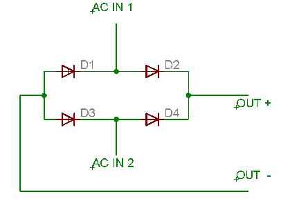

No, because current is only going to be flowing through 2 diodes at a time. If you want me to sketch you out a picture, it's not a problem.
ahh so 2 diodes are for the negative cycle and 2 diodes are for the positve cycle
a picture might help me lol im kinda one that learns with sound and images rather than words
Sure, I'll sketch one up for ya. Give me a few minutes. But yes, you have it right.
