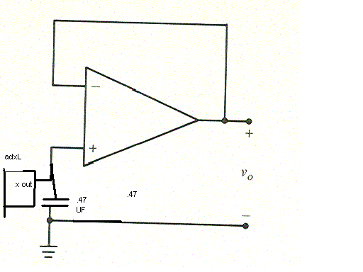

I checked the x out pin of the adxl with a DMM and I get 2.5v at 0g. I'm wondering how the DMM can read a voltage at such a high impedance. Also I built a unity gain buffer using a ti tl061acp op amp. I have +12v on Vcc+, -12v on Vcc-, the output connected to the inverting input and my multimeter, the adxl connected to the non-inverting input. I am still getting a 0 uA reading on the DMM. Any Idea what is going wrong? Thanks
Hmm! I did a little testing. When I measure the current output of my buffer with my DMM it shows notthing. BUT when I measured it with an analog meter It puts out plenty of current to drive the A/D in the pic. Is there a reason that the DMM shows no current flowing?

The output of an opamp buffer is a voltage, not a current, connecting a milliammeter in this way isn't going to work properly anyway, but it's more likely to damage the meter than not give a reading.
Perhaps you had better post the circuit you're using, so we can see what you're doing.
It may be a voltage but there should also be some current even if its very small at the output. Here is a diagram of my circuit. Hope it helps to clarify this a little.
that .47uF cap is supposed to be connected to ground. and i believe the op amp input can be connected between the adxl x output and the capacitor.
this will work , sorry for the look of it.
