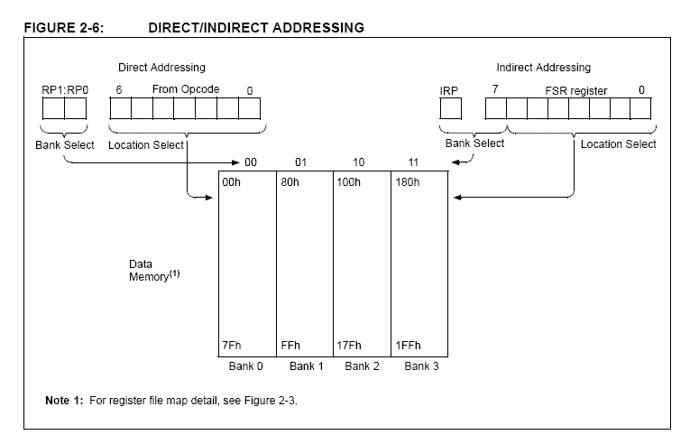

I wounder how it works with the STATUS register on a PIC 16F877.
I am using adress 03h. And that works even if I am in Bank1, where i probably should use 83h instead.
Should i use the correct adress for each bank I am in or is it ok to allways use 03h?

There is no 'address 83h' as such, it's just a convention for the assembler (that replaces it with 03h). The actual address 83h is a GPR in bank zero.
STATUS (as clearly shown in the datasheet) is present in all banks, using 03h is fine, it's what the hardware uses, and it's what the assembler uses.

The address of any register is stored inside each instruction as 7-bit. Therefore, it makes no difference if you use 03H or 83H to access STATUS. They all become 03H when the highest bit is dropped.
Similarily, even if you use 85H, you are still accessing PORT A if you are in bank0. Or, 05H would allow you to access TRISA if you are in bank1.
The full address only matters when one uses indirect addressing where all 8 bits address is being used. So using indirect addressing, one can use 05H to access PORT A and 85H to access TRISA.

Now consider the following code, with the IRP bit=0:
movlw   TRISA   ;W will contains 85H, not 05H
movwf   FSR     ;FSR now contains 85H
movlw   H'FF'   ;W now contains 'FF'
movwf   INDF    ;all port A pins are now set as inputs
The above code will not work if TRISA has the address 05H, because 05H is the address of PORT A, not TRISA. So the assembler only cut off the eighth bit during direct addressing, but use all 8bits for indirect addressing.
Safe, but not quite. It drops the nineth bit during indirect addressing(EECON1 address becomes 8CH instead of 18CH) so the IRP bit must be correct in indirect addressing to access the EECON1.
eblc1388 is right. We can see that FSR will take an 8 bit address. This picture should make it clear:

In the case of the STATUS register, if you look at the register map, you'll see that STATUS is defined as being in more than one bank at the same relative place.
Actually, this entire thread has really been pointless (although educational!), because you DON'T refer to the status register (or any other register) by it's address, you simply use it's name 'STATUS' and the assembler inserts the correct address (in this case always 03). That's the point of using the MicroChip include files.
