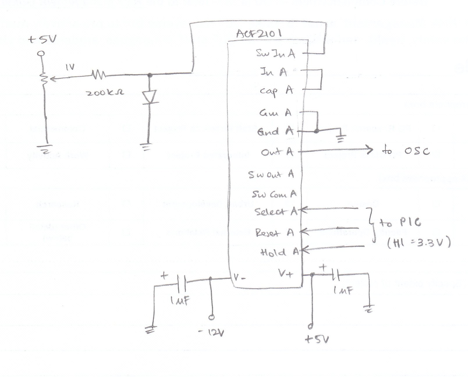

Here you go,

Studying the d/s for the IC.
The normal supply for the device must be +5, -15V and
the voltage output range is typically -13.5v thru +0.5v
Its states that the digital inputs are TTL compatible
Integrate Mode, the output voltage integrates negatively towards -10V
Hold Mode, the output voltage remains at its present value.
Reset Mode, the integration cap is discharged to analog common.
What is connected to the 'osc' pin on your sketch.?
Is D1 0.4Vfwd drop and where is C1.?
The documentation on this device is limited.
All the parameters are quoted for +5V/-15V operation.??

Yup, that is the operation of the chip. I have tried using a -15V supply as well. The 'osc' is supposed to mean that it is connected to an oscilloscope.
D1 forward voltage drop is <0.4V, which is whats required. I did not have C1 as the datasheet states that "addition of either C1 or D1 in the circuit is critical for proper Hold mode operation", so I thought that having D1 was enough ?
I would try the following test.
With RESET & HOLD sw's open, disconnect the PIC.
HOLD high to +5V via a 1k resistor and RESET tie low to 0V [integrate mode]
Use the current source as you have drawn, [set for about 50uA, the output should integrate to -10V.
You say in your 1st post that the clamp diode is 0.02Vfwd.???, perhaps you are sinking the charge current thru the diode rather than to the internal cap.?

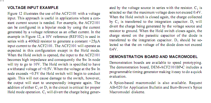

Hi Eric,
You are right, now with the correct supply voltage (-12V), turns out the charge current is going through the diode to ground. When the diode is removed, the chip manages to integrate, although in the Hold mode (which is what is expected as in the datasheet pg. 13). The addition of D1 and/or C1 is supposed to prevent this and ensure that the chip integrates only in 'Integrate' mode.
However, I do not really understand how the addition of D1 and C1 (to ensure that 'Sw In' voltage does not exceed +0.5V) will still let the internal cap charge ? Doesn't the charge go through D1 straight to ground ? Also, if C1 is charged, wouldn't C1 charge up to the near voltage source's voltage ?

The only info I can see is this extract from the datasheet, the way it describes the function is ambiguous in my opinion.
Its suggests that the timing of the HOLD/RESET functions has be such that the C1 transfer charge is held below 0.4V.???

Use a standard silicon signal diode in place of the Schottky diode, ideally you want 0.4Vfwd at about 100uA.
The integration period is in the microseconds region, you need to correctly cycle the HOLD and RESET pins to get a meaningful negative voltage from the output.
You require an inverting buffer from the output of ACF2101 before its input to the PIC, also scale the output down from -10V to +3.3V

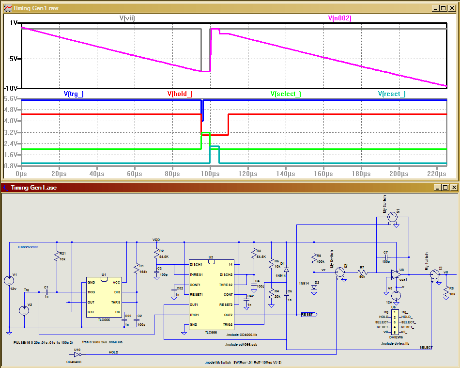

hi dgnr,
I have made a rough simulation in LTspice. The timing circuit and components as the datasheet, I have inverted the HOLD/RESET & SELECT for the sim only.
