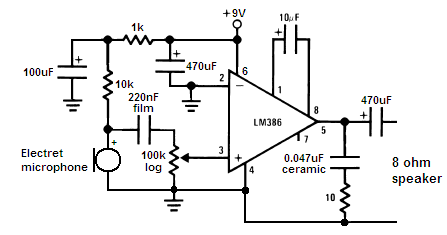

Any idea on which electret mic specifically works well for this and how would I mount it? I am looking at Digikey and there are quite a few with different specs. Also, what would the preamp setup look like, something like this?
Is the preamp just to buffer the signal before it passes through the 386?

You don't need the transistor preamp if you add a capacitor between pin 1 and pin 8 of the LM386 which increases its gain.
Make it like this:

Does the mic attach to the guitar body much like a piezo? I already have the parts for the Little Gem so I was just wondering if I could just replace the piezo with the mic.
The Little Gem MkII has a capacitor as I mentioned to increase the gain but it does not have the bias resistors to power an electret mic.
An ordinary electret mic is a normal microphone that picks up sounds from the air, not a contact one.
Somebody makes a piezo contact mic that is made to be mounted on a guitar. Maybe you can make one from a piezo transducer (speaker) which is different from the piezo in a beeper.
