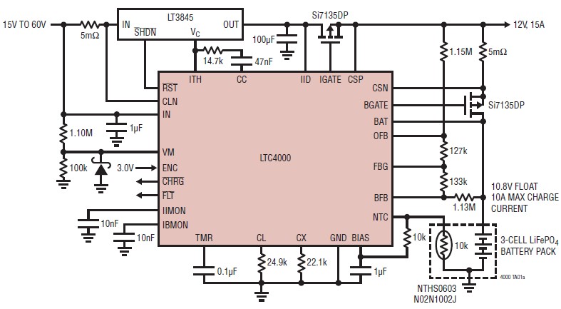

I'm currently in a situation that I would like to activate or let the charging circuit work. I will use the attached circuit.
what I thought about is just use the GND pin of the ground circuit and connect it with a switching transistor, so that when I want to activate it, just pull the transistor to ground and give the charging circuit a ground through the microcontroller, is this a working approach or there is better?
The LTC4000 has an "Enable Charging" -pin:
"ENC (Pin 5/Pin 1): Enable Charging Pin. High impedance
digital input pin. Pull this pin above 1.5V to enable charging
and below 0.5V to disable charging. Leaving this pin
open causes the internal 2μA pull-up current to pull the
pin to 2.5V (typical)."
