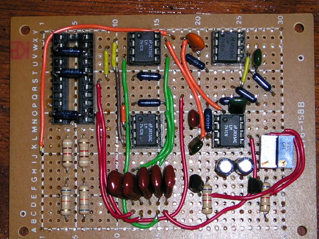

Active filter project 90% complete.
Juglenaut

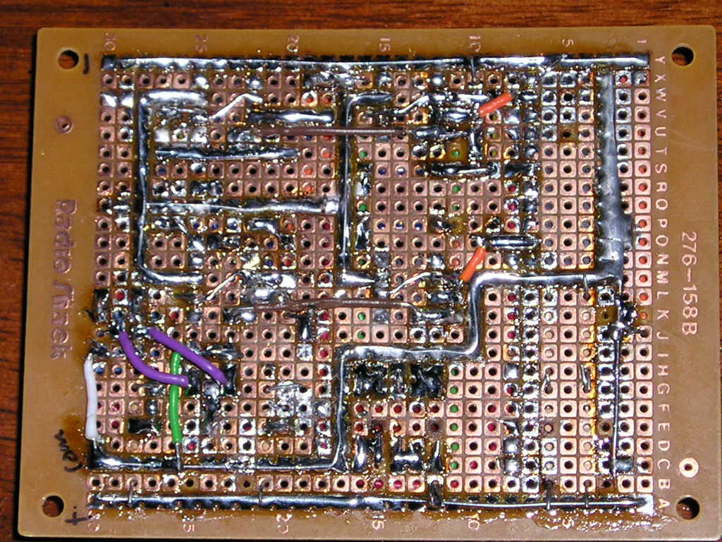

Well first off this prototype is for a school project, Radio shack PCB's suc, I did this as cheap as I could and it shows, I also spent little time engineering the layout before hand.
I used what I call progressive engineering assembly prototype.
Made on a single side pad per hole PCB that I got for free, all components except for the little blue resistors were free.
I think it looks fugly, you might too.
I soldered almost all traces by hand, the rest by jumper where room yields. Has a 2 stage transistor amp, 4 op amps, and other stuff. Mono active filter with up to 100 gain (adjustable) amplification.
The active filter passes all specs given by the instructor and is fully functional.

Hi Juglenaut,
Congratulations for completing a well-working project! :lol:
Yeah, it looks kinda fugly, Veroboard would have made it smaller and less messy.
I hope you are not using it with wideband audio, its old 741 opamps are lousy above only about 8KHz.
Are you using Panasonic reddish-caps? I like the European blue rectangular ones.
The filters band is from 650Hz to 4.2kHz. The caps are general purpose panasonic mylar, and one critical cap is a 1kv 0.1 tolerance ceramic, the blue resistors are multi-purpose millitary 1/2W .01 resistors from dale/vishay, which I got a ton for free.
The group I was in was skeptical about active filters, but I pushed for it to be this way because of the rejection characteristics. The wanted to use passives. Anyway the group leader (or he so self claimed himself) built a breadboarded version that worked sorta well, it had alot of noise, he also wanted to dictate the prototype, but that where I drew the line and took on the prototype engineering. They wanted to fit all the components that was on the breadboard, which had alot of double in-line resistors to make the right resistance, onto a 2 inch squared board!
I will do a follow up of the finished enclosed design next week.
BTW, the old 741 opamp also has a lot of noise.
Why not use a low-noise, wideband and inexpensive opamp like the TL071? :lol:

I didn't use fancy op-amps because this is a school project and we are talking about Tech school level quaility components here. We were asked to use as many components on hand as we could. I had some resistors that were more exact than what the back room had in stock.
The only op-amps they had were the 741's and I didn't feel like starting another argument with the instructor and the group.
The circuit was tested for audio harmonics today and past within reason, it is realitivly clean. If the band doesn't go above 8kHz then why?? this doesn't have to be Hi-Fi

I like the workmanship for the board you have used. Have you ever tried Tripad board. It's like vero-board but instaed of strips it uses blocks of
3 by 1 holes in size.

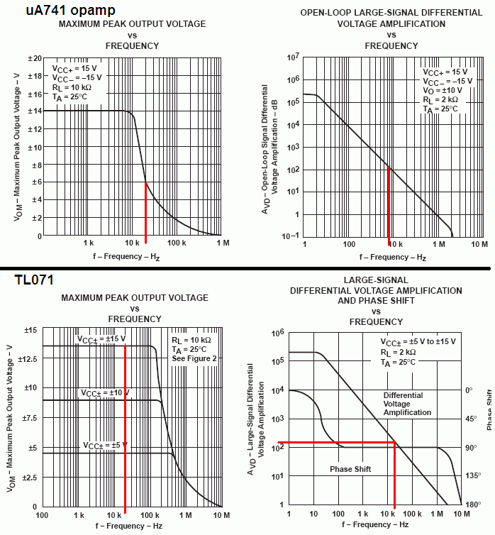

I mentioned the poor quality of using lousy old 741 opamps because it is an active filter project which are usually used for audio, it is being built and tested by fairly young people who should be able to hear frequencies much higher than a lousy old 741 can produce and because the group leader built one that "had alot of noise". Besides its poor bandwidth, the lousy old 741 is known to produce alot of noise.
You can purchase four TL071 low-noise and wideband audio opamps nearly anywhere for about the cost of a cup of coffee, or half the cost of a cheap hamburger.
I think that school textbooks, teachers and stockrooms are way out of date. The last project I built with 741 opamps was in 1976, and have used TL071, 072 and 074 opamps ever since.

The lousy old 741's slew-rate limits it max output above 8KHz, so at 20KHz its max output is only 40% of its supply voltage.
It also rollsoff the high frequencies depending on gain. You have a 1M feedback resistor and a 6.2K input resistor, so its gain is 161. A lousy old 741 opamp will rolloff at about 7KHz (the graph's gain scale is log).
