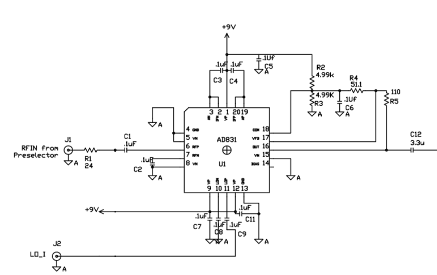

I am very new to RF design and could do with some help & advice. I am using an AD831 mixer as shown in the attached circuit.
The video shows the circuit on my development board and what I think is the two mixed signals. This is without any voltage connected to the device 9v?
When I connect a 9v battery the chip starts to get hot. I have checked and double checked the circuit. It's basically what is described on the datasheet. Why should the chip be getting hot. Also the voltage drops from 9v to 8.6v when connected.
It appears that the mixer IS doing something. When I adjust the signal generator you can see the waveform change.
Is this the kind of trace I should expect to see?
Why is the chip getting hot?
The datasheet tells us that the quescent current is 100/110mA, which with a 9v supply is getting on for 1 watt.
So it will get hot.
Also your little 9v battery will be working quite hard, which is why its voltage drops a bit.

This mixer is intentionally designed to use a fair bit of power to do its job. While it takes about 1 watt of DC power to run it, the output RF power is typically very small, so this is a very inefficient IC from a power consumption point of view (for good reason, read on).
I notice that you can make it less hot if you don't mind a minor reduction in dynamic range, simply by tying the BIAS pin 14 to VPOS through a small resistance. This BIAS pin is used to program the current drain, and they say that current consumption (and therefore heat) can be reduced by half if you tie this pin to your positive supply. I think this might be a useful thing to do while you are still playing around. Later on, if you need to increase performance, you can adjust this. In the meantime, it keeps the chip cooler which will make you feel better.
